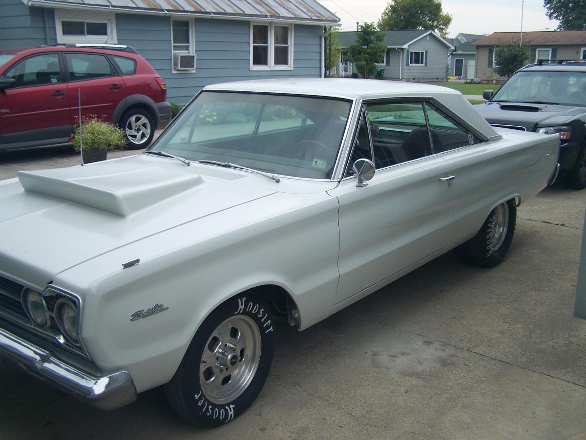

Here it is now... I still have to cut out the scoop and build an air dam below to match up to the 440 carb. I'll wait till the new engine is in first though...
and again!!!!!!:edgy:
