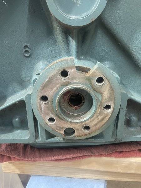

Not sure if photos help but here they are.

It looks like the flywheel is the problem I would not use that one.
A replacement 143 tooth 11 inch flywheel should be the fix.
You might want to take some measurements on the flywheel before you drop more coin. It looks pretty funky on the engine side, but I’ve never had a factory 11 incher
