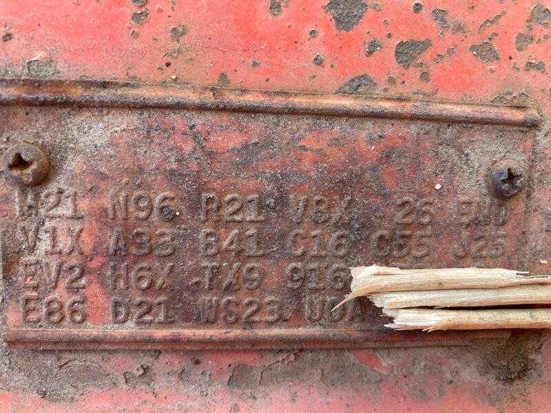

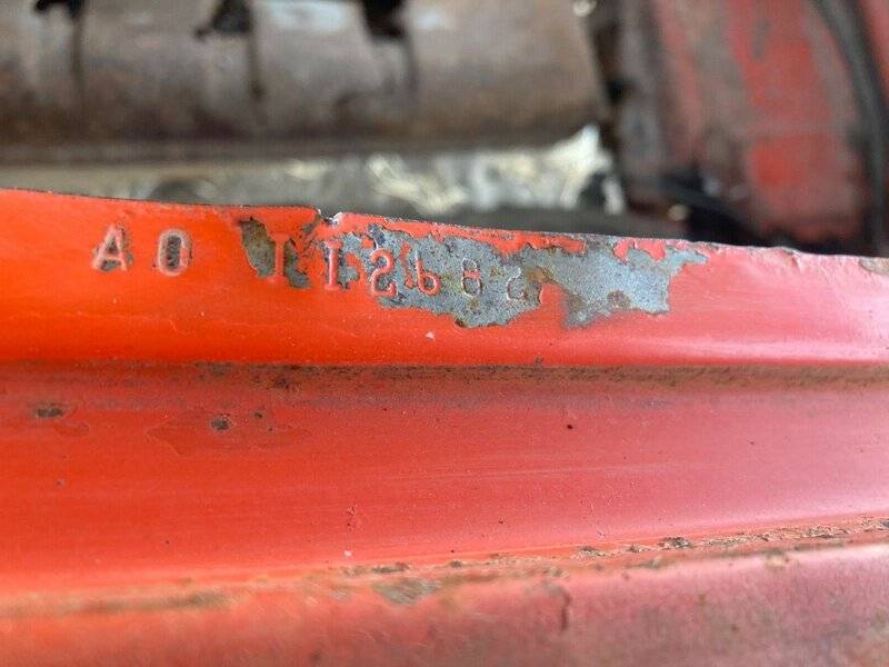

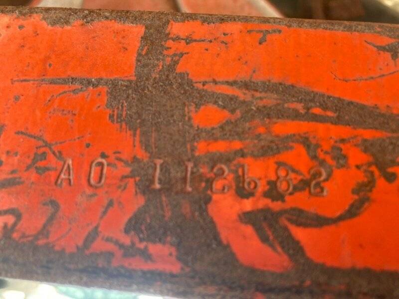

I feel like I'm seeing "500" with a tag and scoop swapperoonie? Sent a note to seller inquiring about title status as there wasn't any I could find in the ad. Bid is at $5K reserve not met. BIN for $25K. Doesn't mention an engine or trans. Caveat Emptor.
150 speedo
It's the AC mostly that's throwing me...should be on the tag
"....Can't . seem . to . reach . the hood release!..... To get to the Ramcharger....
I agree, 4spd car with an automatic floor, N96 car with an AC fire wall.

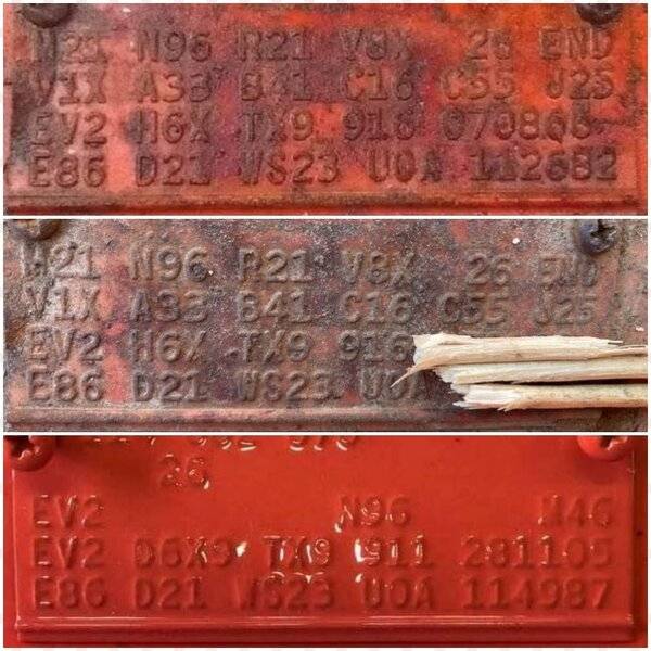

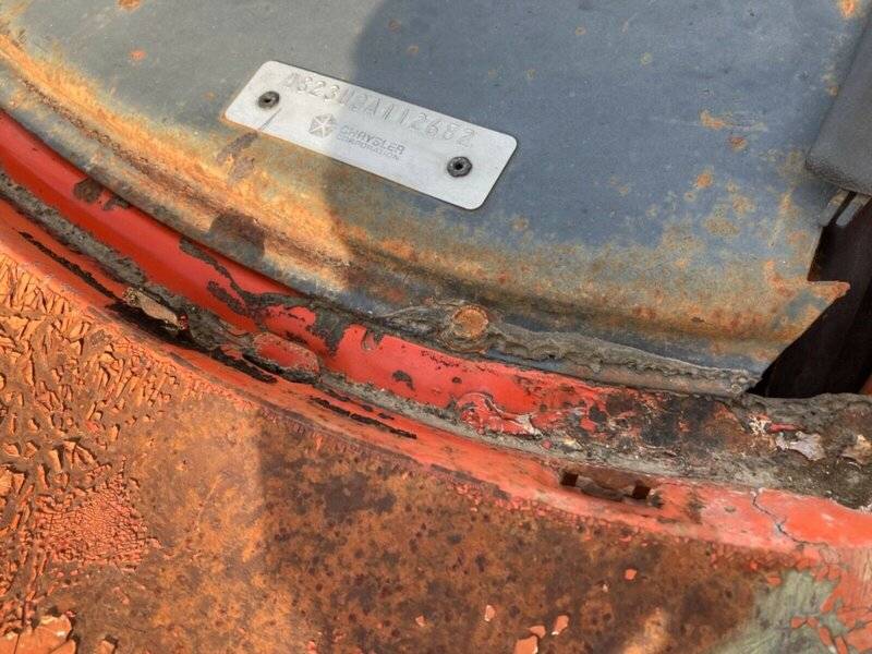

Top pic = Pic I already had with full VIN
Middle Pic = Ebay pic
Bottom pic - legit WS E86 D21 tag
Wrong format, wrong interior code and, likely, guessed wrong at SPD.
This a "semi-professional" chop-shop job from back in the day or something? Copied a St. Louis (or wherever) tag and just changed the VIN digits? Knew enough to swap the 150 speedo, but not enough to know what N96 and or H51 are?
3 cars in 1?
Tags aged a fair amount since your 1st pic - where did that pic come from? Just curious.

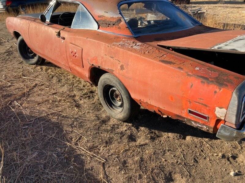

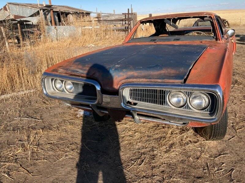

Few possibilities;
Hood gone

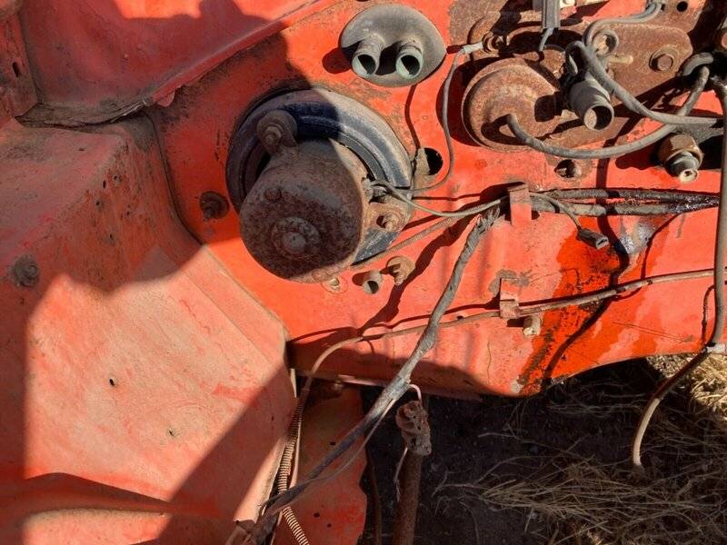

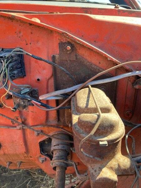

A/c looks to be hacked in? Weird holes in fire wall

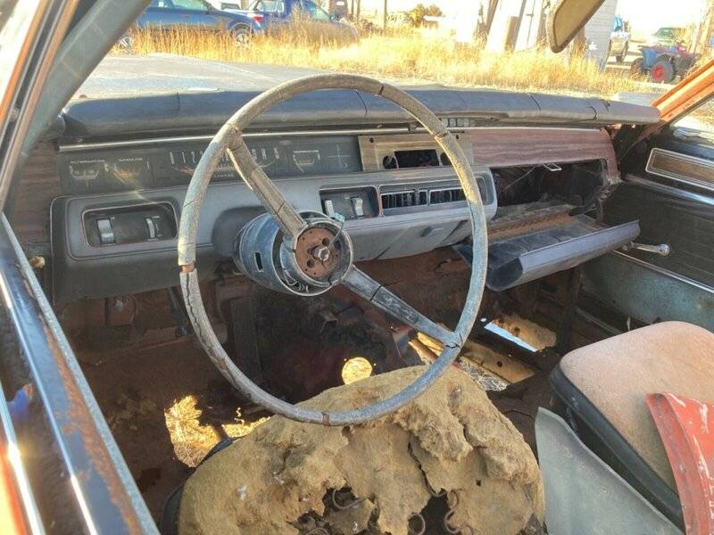

4 speed brake pedal?

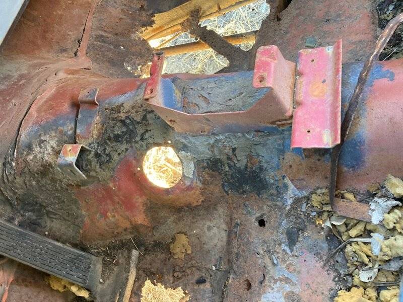

Auto tunnel looks to be painted around where the hump would go? Auto tunnel welded in?
Certainly anything is possible, but that tag would still be troublesome - Where did all those option codes come from? A regular Lynch Road tag would have listed the 26" radiator and the N96, but probably not much beyond that, option-wise. Maybe the console? 69coronetrt would have a better read on that than me. The H6** wouldn't be used for this car's interior - the D6** is what it would be.
Few possibilities;
Hood gone
agree on the a/c, the cut out for the blower motor looks rough too ....... i saw a detached non matching 4 sp hump in one of the pics
looks like an auto, non a/c car with 4 sp pedals to me, someone was building a 1 of 1 lol
