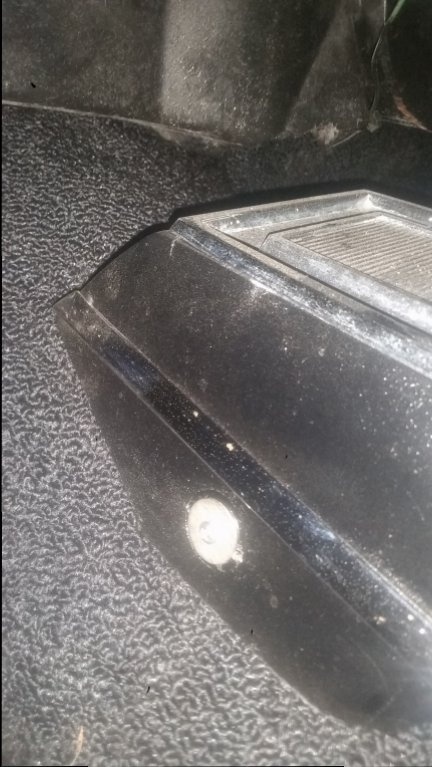

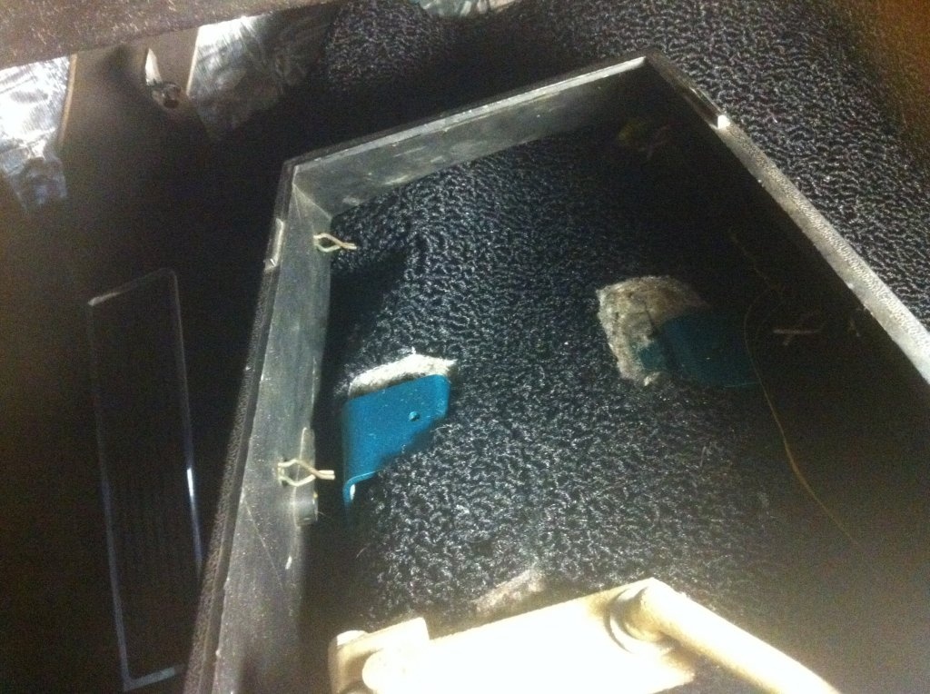

Does any one know what the forward console welded to the floor bracket is for ? Does it attach to anything? What am i missing here ?
My 66 Satellite has one at back of console inside lid are hold down screws to the bracket and one under front plate behind auto shifter.

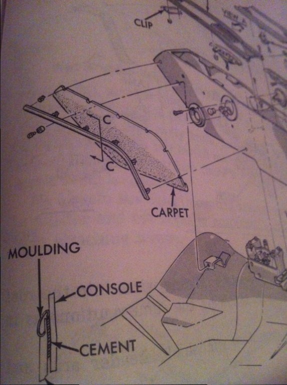

Yes i checked the MM and it clearly shows a screw with fancy washer going tru the glued-on carpet piece + console into the driver side bracket and clearly nothing on top! Thanks
