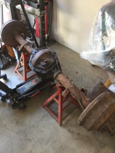

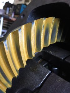

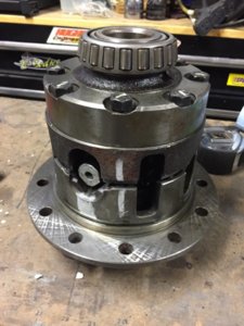

The Dana 60 I bought was a full floater, brakes, axles and the ends all get circle filed. But it did have 3:73’s, so I checked them over, deemed good to reuse, kept all shims as they are a good starting point for reassembly. I got a 35 spline power lock (sure grip) from Cranky and then ordered a master ring/pinion rebuild kit and got busy.

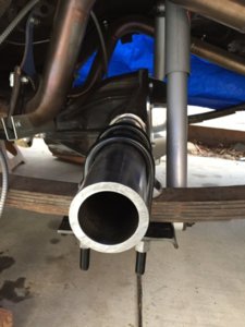

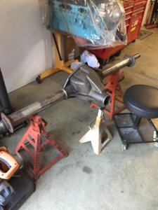

Now my buddy wanted to do the same, found another Dana 60 and it was a semi floater, it was a 30 spline, but he’s gonna go to 35 spline. Tore into the power lock, clutches were shot, so he ordered a new kit from Dr. Diff, along with new cross/spider gears. Now I’m in the middle of measuring it so it can fit his Duster a 4 link.
Now both of these Dana’s have 3/8’s thick tubes and are 3.125 in diameter. Not a big deal, just be aware of it cause if you plan on reusing your u-bolts, not gonna fit.
E81AE0C6-9FF1-43F6-AF53-58395CED40DC.jpeg F2EEDE5F-4690-4E58-9068-97A0A7FF9F10.jpeg 1392334F-FF29-4B2F-88BC-35E3DD87BD22.jpeg 0E0A4334-9F84-4543-8602-1092CBDAD728.jpeg 93DFDDC8-D505-4CC1-A29A-989380440816.jpeg
Forgot to mention that your gonna need to narrow those Dana’s, figure 2-300 for that job. I had a few 8 3/4’s narrowed, decided to do the Dana myself, had the narrowing pucks made and got a centerless ground 1.250 solid bar, 6ft in length and did it myself, also had the pucks made for the 8 3/4, so I can now do both.
Rather then swap the ring and pinion, just swap the traction lock into the existing open diff housing. Measure the backlash before disassembly and duplicate it. Tube diameter isn't a big deal on leaf springs as you can fudge the spring plates and housing mounts gusset from the front and rear. Egg the holes in the plates. Get new U bolts. You can buy new ends or cut off a pair from a scrap 8. 3/4. I weld the housing mounts and ends on for $100.
