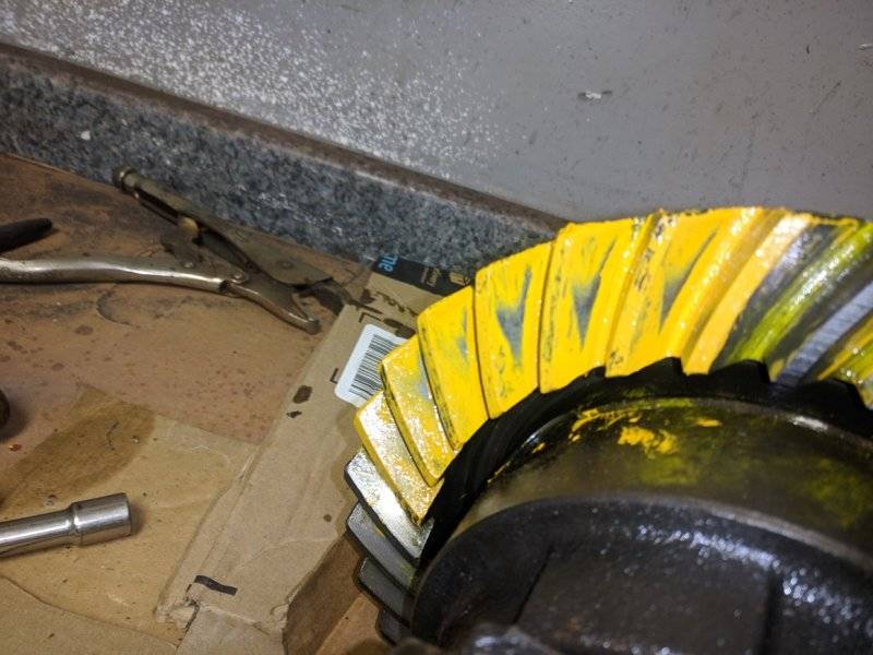

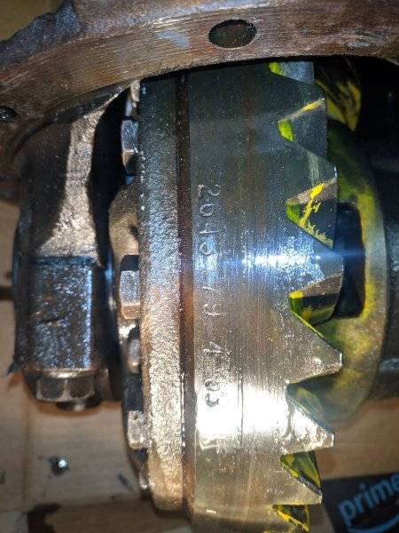

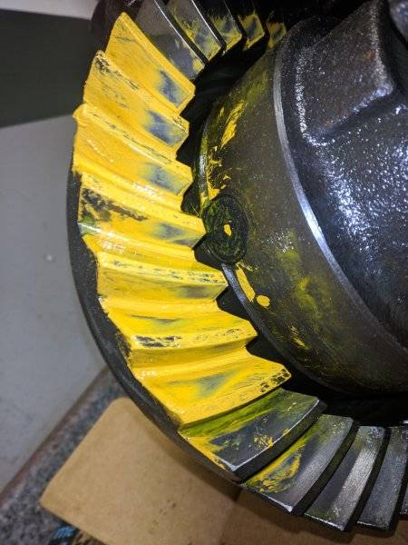

Yeah, I should have commented on checking the carrier ring gear flange out with a dial indicator before mounting the ring gear. If it isn’t real clean and flat then you will have nothing but trouble setting it up. I don’t remember exactly what the spec for run out is but probably just 2 or 3 thousands.
