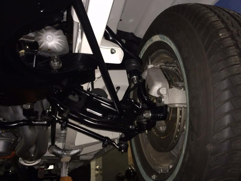

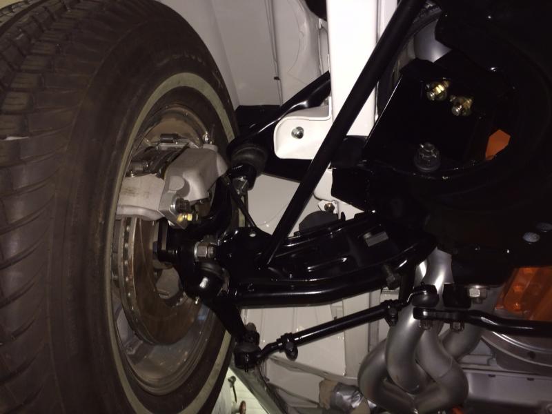

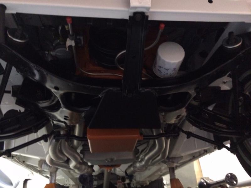

I used a combination of powder coating and Eastwood products on my 65.
My experience:
POR 15 is ****.
Eastwood Chassis Black is pretty good stuff.
As with any coating, the ultimate success lies in your prep. Pay attention to your temps, clean with a wax and grease remover and multiple light to medium coats will yield the best results.
