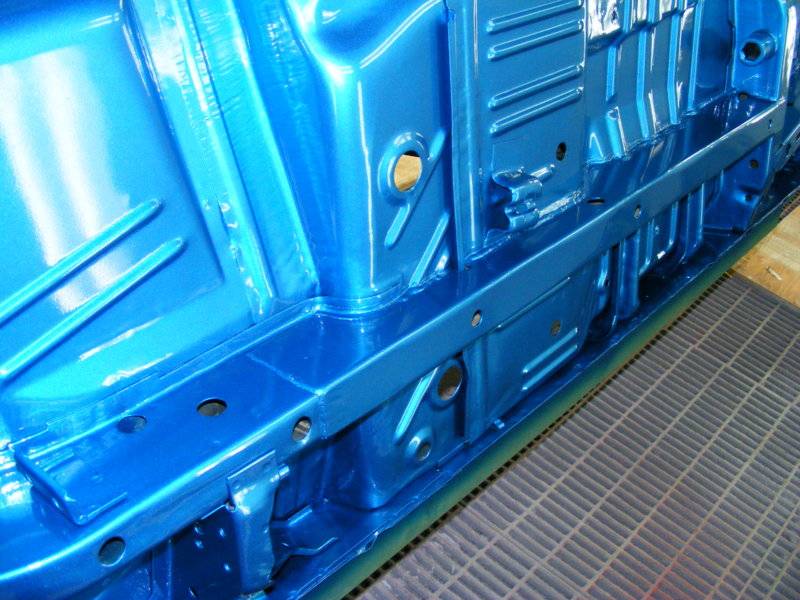

DO IT. Once you do you will probably never have another mopar that you don’t install them on. It was the single most important thing that helped the ride and handling of my car (68 b body sport satellite). I installed global west tubular connectors that are made to weld each end. Don’t buy the bolt in kind unless you weld each end or they will come loose over time. I have several friends running the US Cartool connectors that weld along the contours of the floor pan which look like they came from the factory once installed.
Let’s put it its way - my buddy on here Dennis H romped on his mildly rebuilt 440 with 5 speed keisler pushing just 500 hp without the connectors and told me his windshield popped out from the unibody twist. Once he installed US Cartool connectors no problem. The thing I like is you will have less squeaks and rattles and the car feels noticeably more solid while driving but not at all stiff. Go for it!

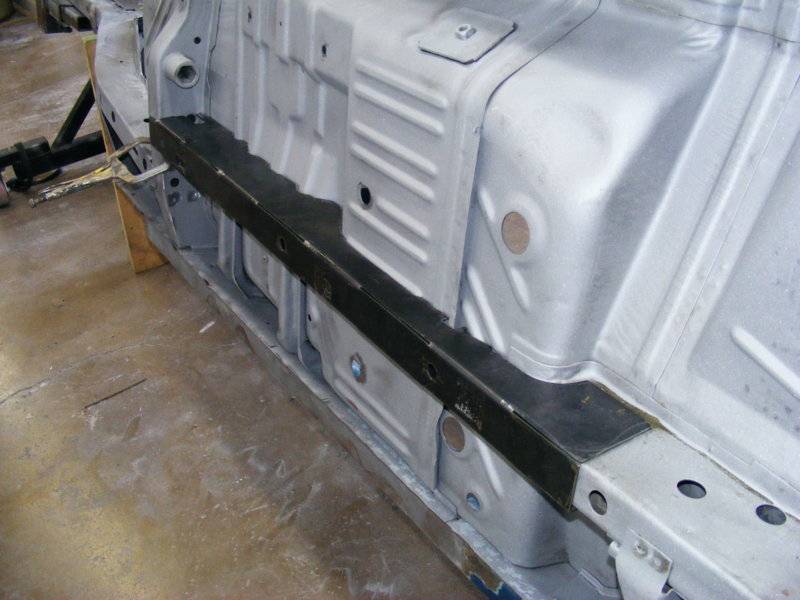

Great thread. It goes without saying that when these are installed it is imperative that the car be supported straight. IMHO It is worth the $'s to seek out an "old guy" with a frame rack to set the car up and weld in. These guys work with this stuff daily and most are excellent welders. After they are in they will help you realign the door gaps and adjust the torsion bars. Also while there they can adjust the alignment based on what your going to use the car for. That also make a huge difference in a track car at 130 mph. Dave
Did mine back in the day with a single-post with 4 swing arms. Never a problem since, no cracked welds && I was not even close to being an expert welder! IMHO the best thing to do to a uni-body.
I have installed them on many cars over the years. Several were my buddies street cars. Yes, they do make a difference even for a mild street driven car. It does not need to be a full out drag car to benefit from them.
Installed them myself on my 67 Belvedere convertible in my garage
- - make sure all 4 tires are on the ground and level
- - do your adjustments to the connectors
- - jack them up into place
- - then check doors for proper opening
- - tack them in place every 6"
- - check the doors again - no jack
- - weld them in
