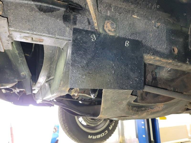

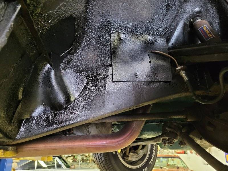

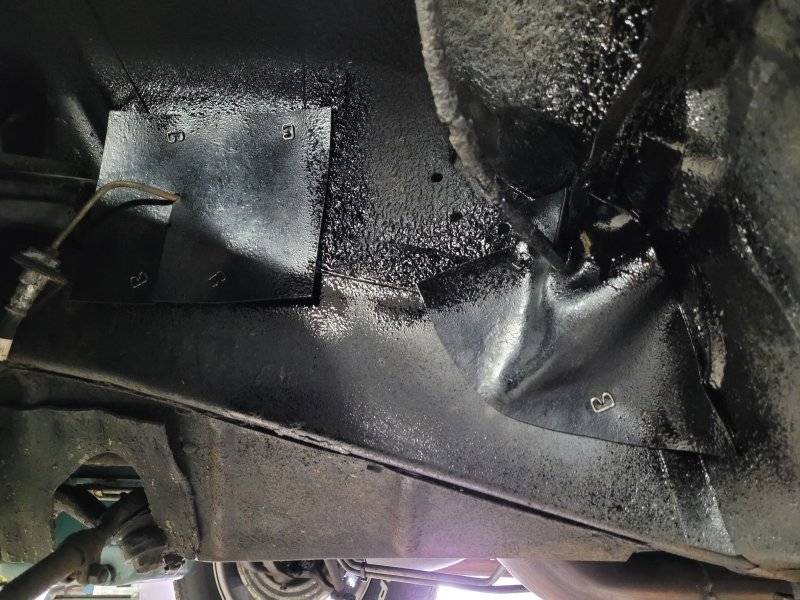

Finally getting around to installing these. DMT's #'d pictures, descriptions and package labels all contradict each other. I'm just going by undercoat witness marks at this point.
Is this correct on front frame seals. Just guessing by frame rail holes.
What are you using to replicate the undercoating? Looks dang close.
Dominion Sure Seal Ltd Black asphalt undercoating. It doesn't really have the lumpy OE texture to it but works well to blend new into the 58 year old original.

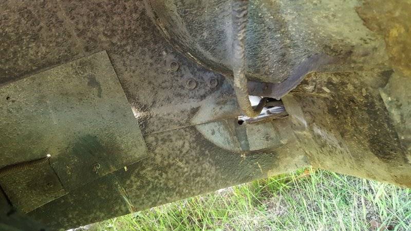

Looks right to me, the one fell off on my driver's side.
Mine also has metal splash shields that bolt to the frame and hang down in front of the strut rod.

Thanks, wasn't the ones in question... it was the front one between the rad support and K frame!

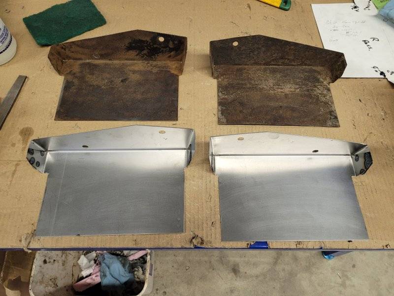

Yes, it's supposed to have the metal K frame splash shields as well. I have an OE set and I've been manufacturing brand new ones!
Yes, I know, just checking. Whenever I mention the metal splash shields people tell me I'm wrong, must be fabricated by a previous owner or some baloney.
Did not have a pic of the front rubber one, but it is correct.
