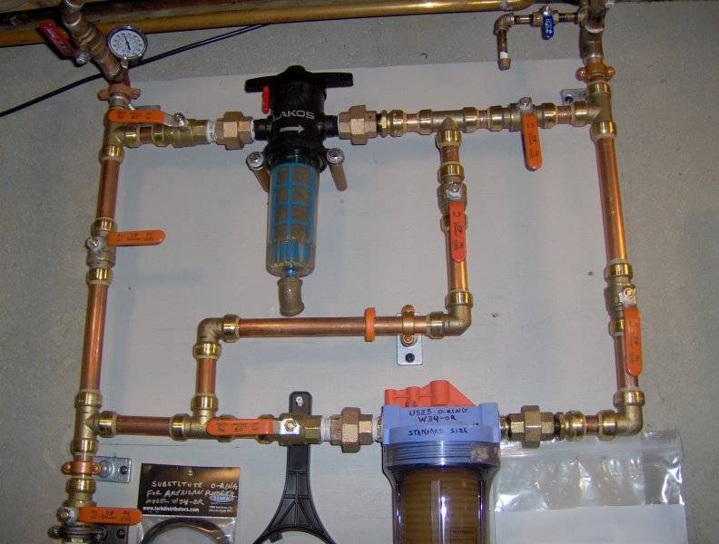

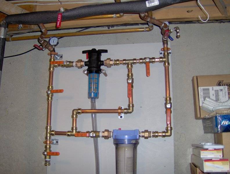

I prep the gator joints just like I would if I were soldering - clean, emery cloth (RADIAL motion, not up and down the pipe), and snap 'em in. Once mated, I strap the joint to something even if I have to block it out from a stud - just to reduce movement under pressure changes. If they stay static, there's less chance of leaking.
I like them because I can mate new CPVC to old existing copper in rental renovations, without having to get all sorts of adaptors and crap.
