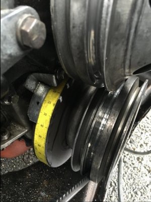

Hello my greasy chums, I have another pointer for those who find themselves a little light in the wallet and a little heavy on the DIY attitude. I present to you a site in which you can create your very own timing tape AND degree wheel in Imperial formatting. Simply measure your balancer and input the proper info and select your color yellow or white and choose to print up or down from zero and direction of engine rotation and off you go. Select the print diagrams button to create the PDF then select the PDF and print. Then just cut it out and enjoy a free timing tape. No need to thank me...
http://www.blocklayer.com/timing-tapeeng.aspx
I used superglue to attach and then a coat of clear coat nail polish to affix this tape
