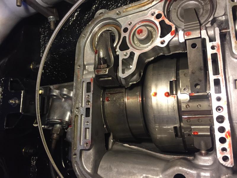

While you have the shift body out, you can see the clutch drums, bands and the like. Look for signs of heat, metal turned blue, or burnt.

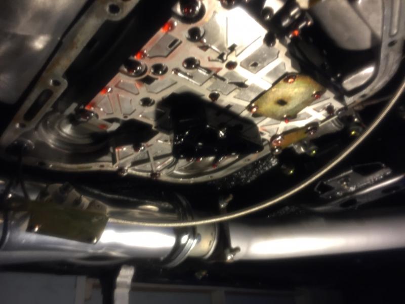

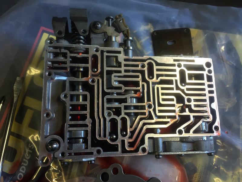

Hers some pics of the valve body. Anyone recognize it?
Fount a couple of flakes of metal in the valve body, looked brassish? Looked like the would have already been in the system and ended up there rather than broken/shaved off.
Sorry pics of the valve body... Number on the plate 045
From here, Malicious, it all looks good. Don't see any galling on the valves, drums look good. Do the valves slide easily in the body, without sticking?
In the first photo, trying to make out the pickup. Too dark...had you already pulled the filter? All extended pickups I've used were aluminum, the filter attaching to the bottom surface.
Only you know how much loose metal is in there. Fluid looks clean. A 'few' flakes could be normal, like your describing, coming off a new spacer, or the like...usually bronze.
But, some reason it's not picking up fluid, or if it is, not making pressure. Might be plain as the nose on your face! If it all looks as good as it does, just look closely at things. You have any kind of manual?

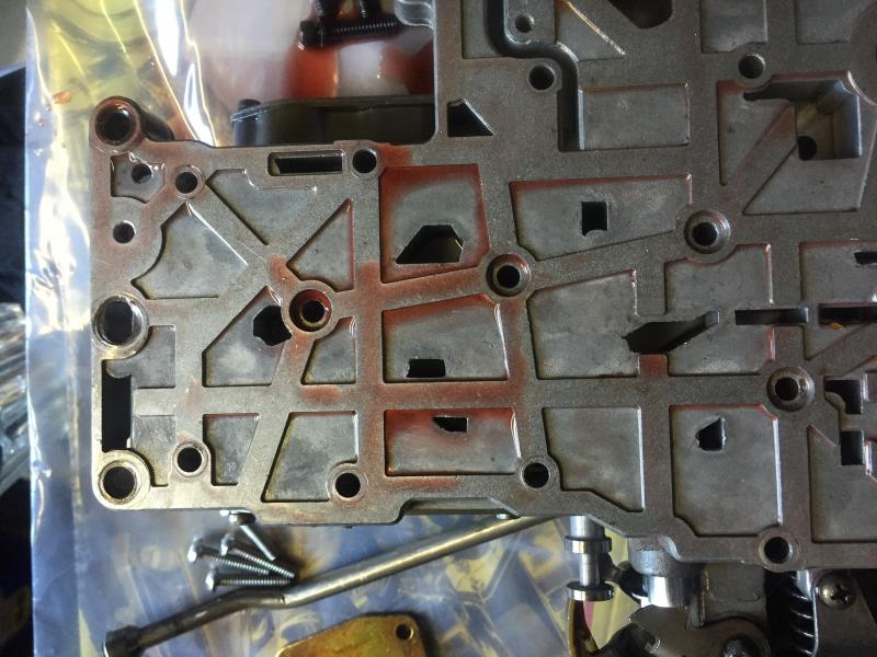

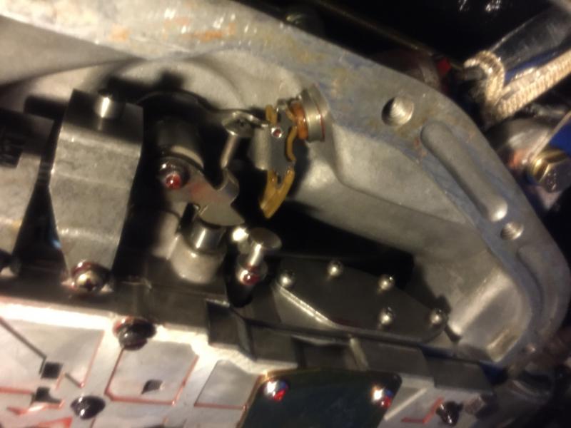

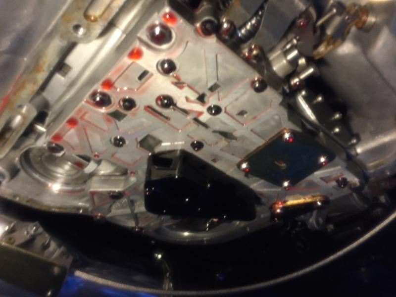

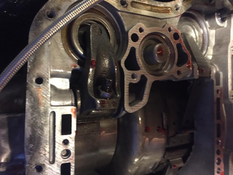

Maybe I'm just seeing things wrong. Photos #4 and 5...rear servo piston...is it there??
Guess it is. Main things causing no shift is bad pump, problem in shift body, problem with servos. If you have a book, since the valve body is off, there's ports you can apply air to, testing the servos.

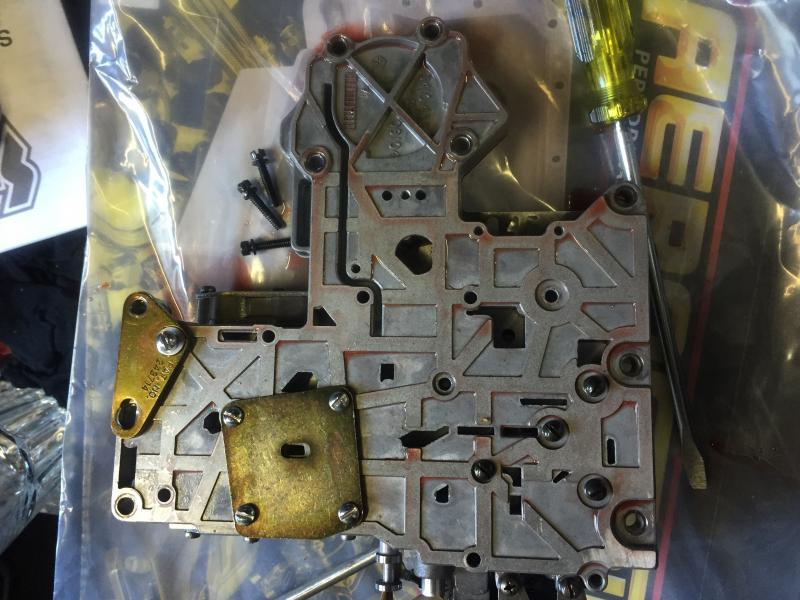

Not sure on the rear servo, the only thing that has come out is the pan, filter, extension and then valve body. Nothing else came out. I'm a bit concerned about what it is, because of the block off plates (brassish plates on the valve body), I haven't sen them in any of my images searches...
Also the whole time my kick down lever had no pressure or spring back. In fact the box never came with a kick down lever(on the outside gear selector), I had to source one. I have heard people say that some times manual valve bodies can be picked by a lack of kick down lever (on the gear selector shaft). Thats why I'm keen to work out what the valve body is, because if it is a manual, I don't want it. Just looking for a slightly worked cruiser.
Pretty sure the rear servo is right (just looked odd, when I first saw it), been two years since I've been in one. But, as mentioned, there's air into port tests that can be done, to be sure they are working right.
Re-looking at the valve body, quite possible it could be modified. Those brass plates don't seem stock. Problem is there's so many modifications that can be done to these things, hard to keep track. I've only built 727B's, so not aware of the difs.
The kick-down lever valve should be spring loaded, so that probably another sign. Never been a fan of some of those mods, except for all out racing. Surprised no one else hasn't chimed in on this, who's used some of the shift kit stuff.
But, that's what your probably looking at. Stock shift bodies can be had fairly cheap. Sorry not much help...just don't know much on the shift kit stuff...never needed it. Any chance the rebuild shop could tell you anything?
Google images to the rescue. Its a Transgo TF-3 full manual conversion. Found the instructions, I'm going to look over it now. However I don't want a full manual box, anyone converted a manualised box back to auto? or do I need a new one?

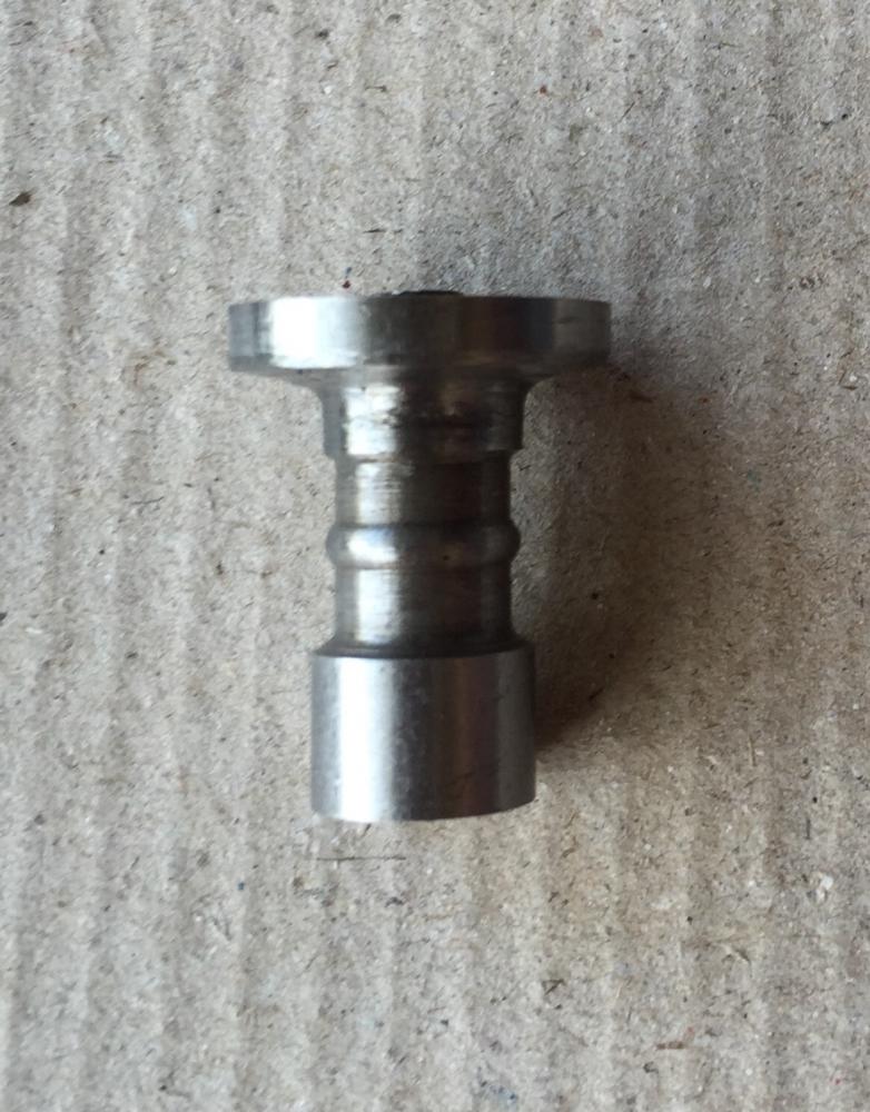

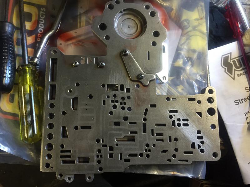

Cleaned out the valve body, all seamed good except this piece: it seems to have been filed. Also the transgo instructions high light the small ledge as only being on a 76 and later valve body, but I think this might be a pre 76 unit. Could this cause issues?
Shouldn't matter on pan depth, as long as the pickup fits the pan.
You can go through the Transgo instructions, to see what all is done...at very least that valve would need to be replaced, since it's been 'worked'. Good you found the instructions! Doesn't mean it was done right, though. If it ain't broke, don't fix it!!!
