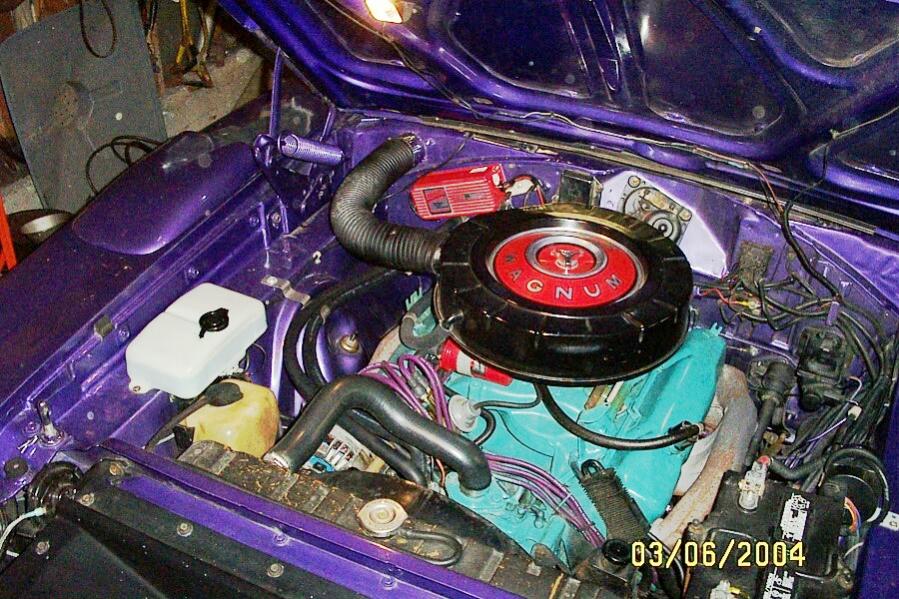

Please don't laugh because it's a slant six but I did this years ago and yes it helped A LOT.Had to cut a 3'' hole in the rad support to run the tubing up to the grille.It was on a 67 Dart but you get the idea.You can find other parts such a filter housing(Mine came from a 76 Cordoba) so you can keep your original. Just a thought.

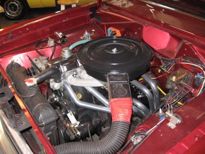

this is how I got fresh air on the Daytona......
