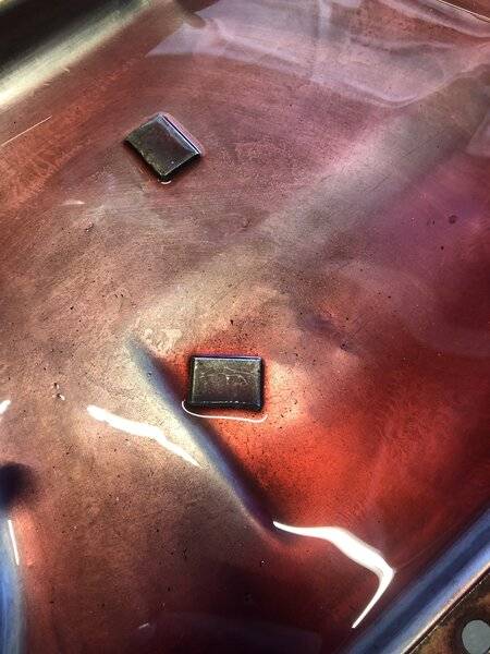

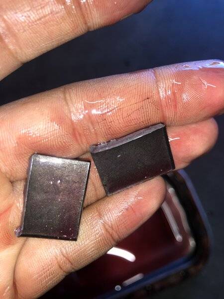

Just installed a freshly rebuilt 727 ( picked up from rebuilder 1 week ago). Installed it, filled it with atf+4. Put car on the ground and immediately did not have first or reverse. Dropped the pan and this is what i found.
3E4CE416-FDAC-4FBC-BDAF-9D70A85E4AB0.jpeg 750F7C9C-28BA-4615-9489-10CA9A70D437.jpeg 81398849-F1C3-412C-B28B-9D03BCF23FAC.jpeg
Looks like a low-reverse band strut, but no reason to have two in there.
Looks like the strut broke in half from here. If so that’s good and a new one can be n the car.

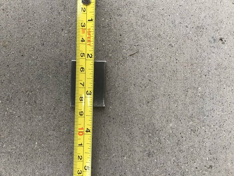

The strut should be 1” wide and. 1.25” long

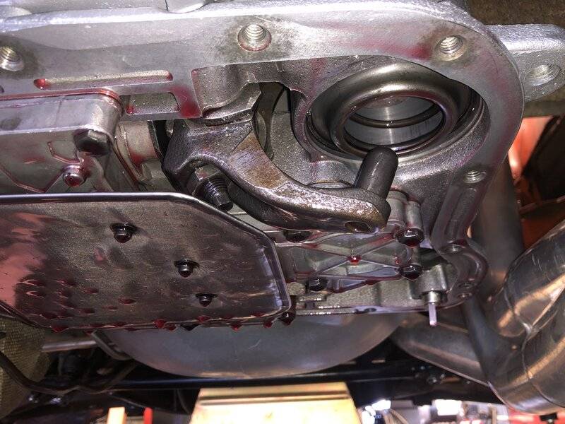

View attachment 1062460 View attachment 1062461 View attachment 1062463
Broken band apply strut for sure. This sometimes happens if you pull it into reverse when rev's are up. Make sure your engine is tuned up and running right so idle speed is correct. You can replace this strut by loosening lock nut and backing band adjustment screw all the way off, and popping new strut between band anchor and lever. Retighten adjustment screw to snug, and then back off 2 full turns. Crank down lock nut, and you are done. I always use the newer A518 pan gasket with the molded-in o-rings around all the bolt holes. These are more expensive than cork jobber gaskets, but they don't leak and are reusealbe.
