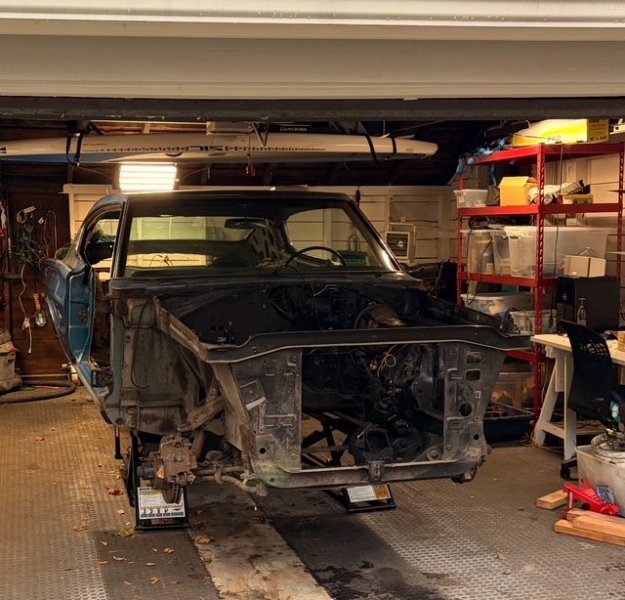

My son and I (mostly my son) are working on rebuilding a '66 Charger. It is the first MOPAR for us but I have rebuilt two VW's and a '47 Jeep CJ2A from the ground up and he has finished a complete rebuild on a '64 Corvair. He lives in Portland Oregon and I live in St Paul MN so I only get to work on it in trips there but his goal is to replace the 400 CI engine it has in it now to a 440CI he got from around 1975 (engine number is 4006630) and bring the horsepower up to 500 or so .. ( I am new to all stuff MOPAR so hope this makes sense)
We are also looking at making sure the existing running gear and transmission is suitable for this configuration. Currently has Torqueflight 727 auto matic and 8 3/4 rear diff

Swapping from a 400 to 440 is pretty easy. A 400 is a "B" low deck block, and a 440 is a "RB" raised deck block. Most things are shared between the big blocks except the intake manifold, distributor and reciprocating assembly.
A 727 transmission and 8 3/4 rear are plenty strong and can be made to work very well.
