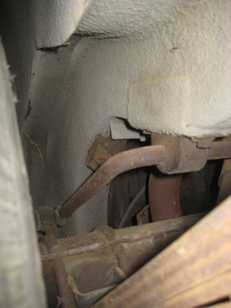

Road Runners had a rear sway bar option for 69. It was available for Taxi and Police cars under the Satellites. The Firm Feel is a very close copy.
Pretty sure the only cars before 72 that could have a rear one were cop and taxi cars. No RR or Chargers.
