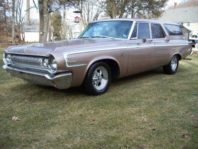

Have a Volare set up on my wagon with the swaybar! Works sweet, handles/stops perfect! 102_4635.jpg
