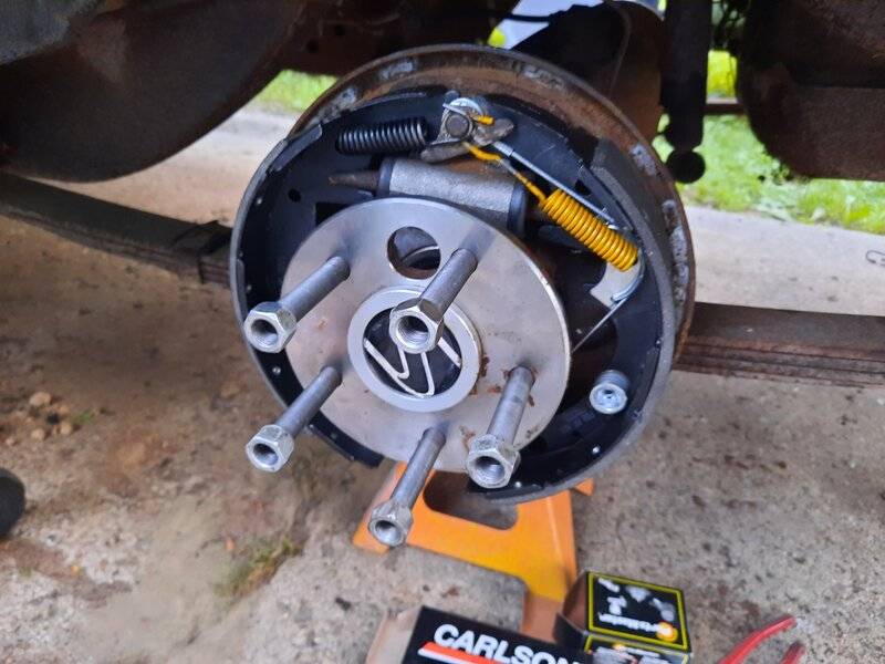

Don't have to remove backing plates. Just did all four corners of my Road Runner with 100% all new brake parts and hardware.

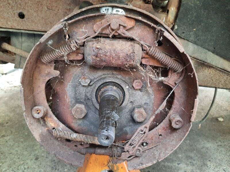

Yes, if you can't turn it with a wrench, rusted, rounded,etc. you have to remove the backing plate on the front wheels to remove the wheel cylinder bolts.
I just had to do it on Uncle Bill's Cuda.
