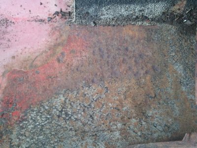

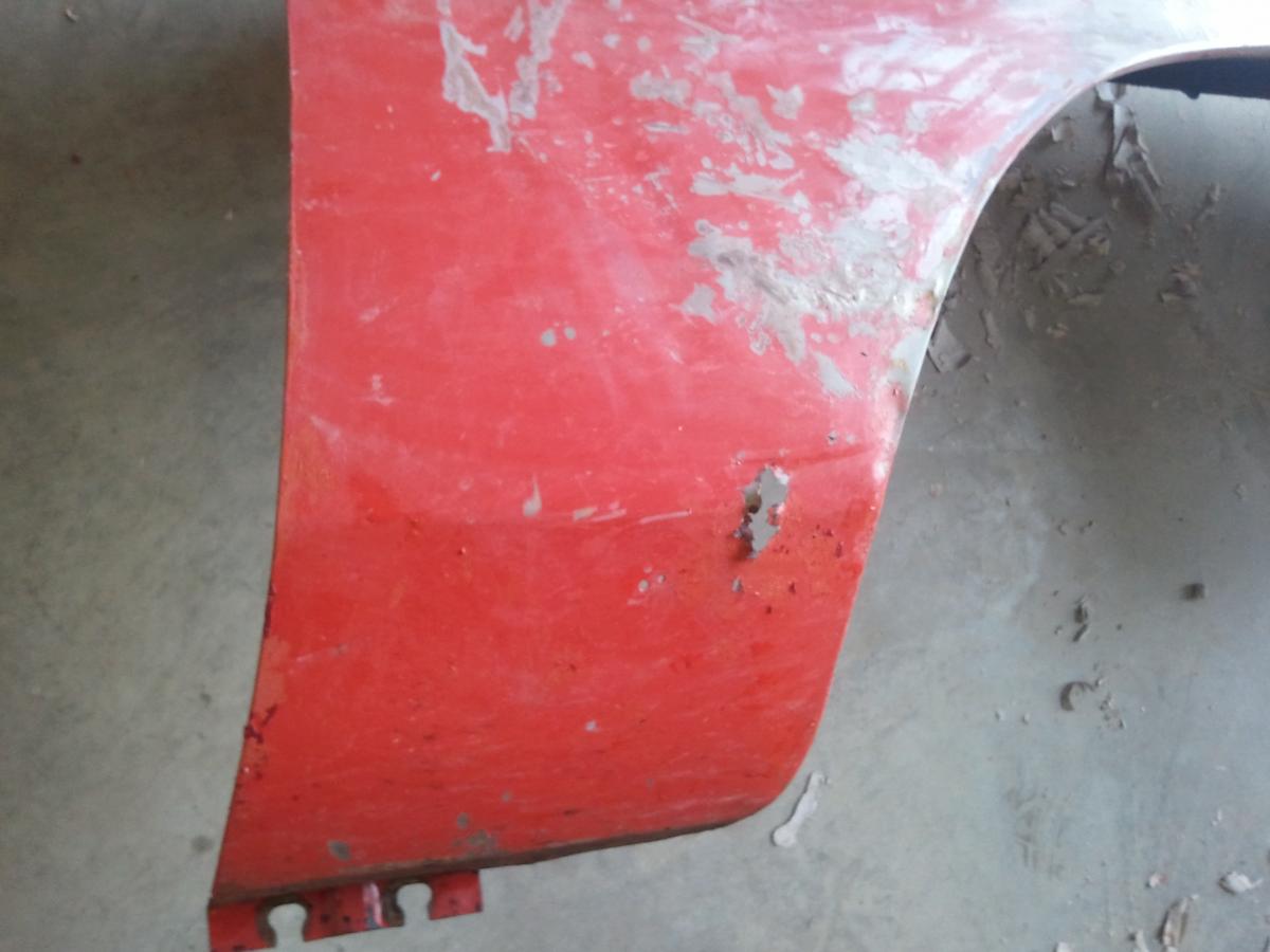

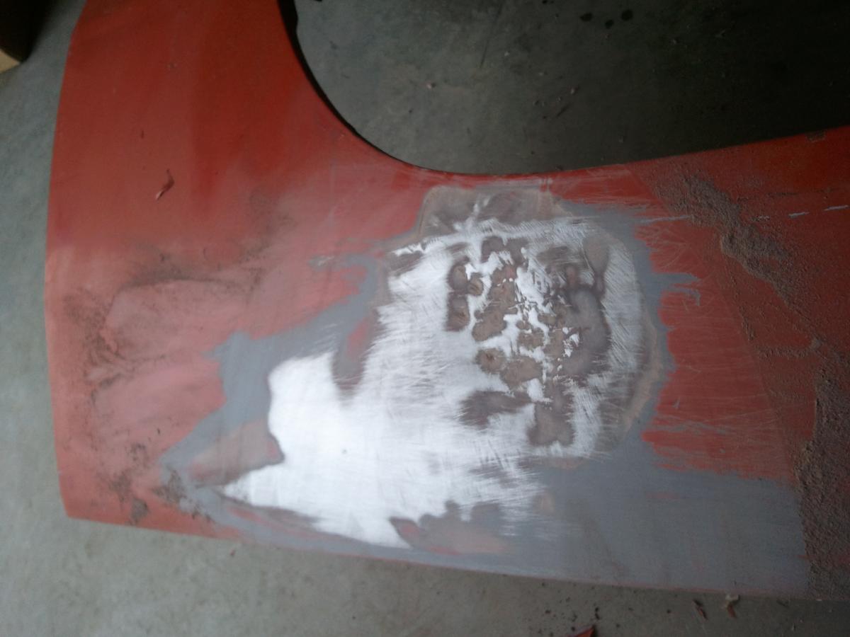

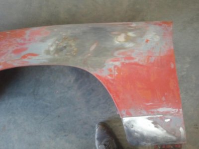

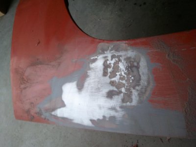

Yeah I have done the torch and wet rag deal before but the disc shrinker looks like the ticket because you don't have to be fiddling with the damn torch #1 and #2 would be much faster and more economical in my view, I am posting some pics I used some stripper today and found this lovely bundle of joy hiding under 1/4" thick filler, Northerndave, I think the same gremlin that got ahold of your fender found mine back there in the 70's! (passenger that is!) I will say this whoever did the bodywork was absolutely horrendous WAY,WAY,WAY too much filler I did straighten the lower dogleg on the driver fender today but I still need to get a shrinking disc and go at the raised spot (they had it pushed in and it had about 1/4" deep bondo pool in it, the pic of the inside of the fender is where the deep pitted rust is that is the only thing that has me worried! We will see what happens to it when I wire wheel it!

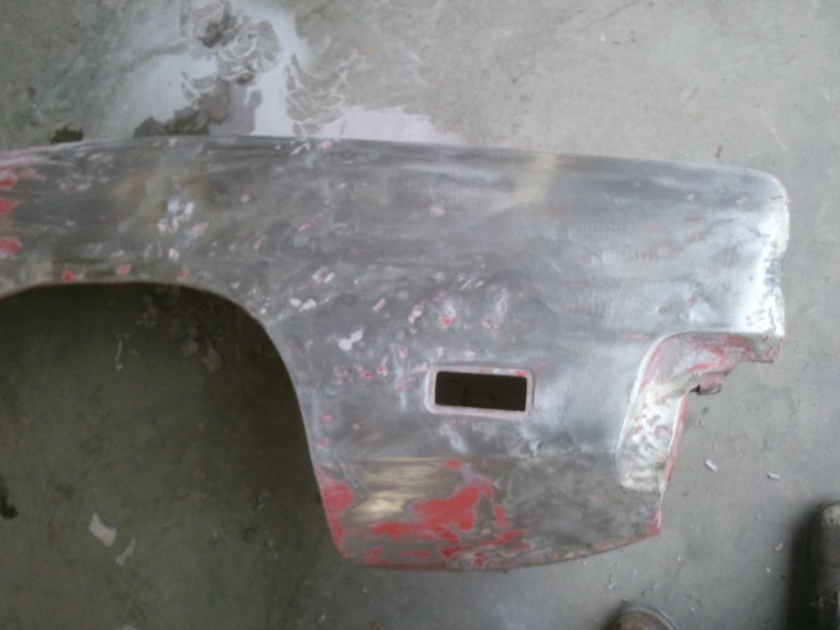

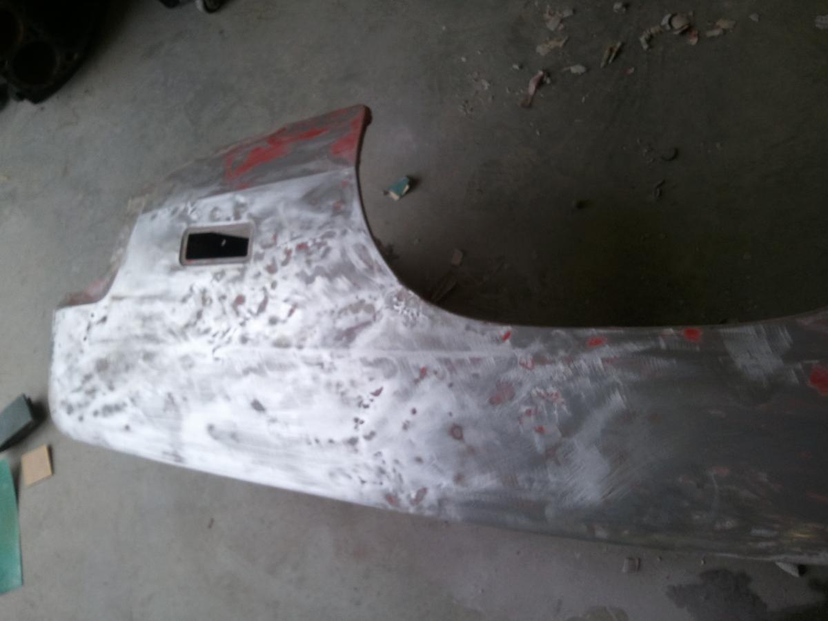

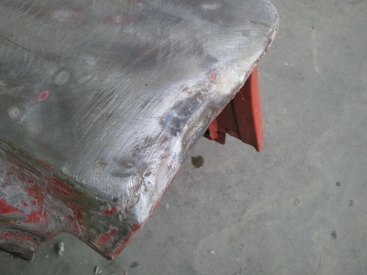

Here are pics of the passenger side fender, looks like someone was playing "Dukes of Hazzard" to incur this damage!!! This fender was also crunched pretty good behind wheel well actually pushed it in, I layed it on the floor and got the BFH out and she is somewhat back to original shape!!! the only rust on the fender is where the fender had been pushed into the rear splash shield and it has a little rust but the rust isn't a issue it's the mother lovin' dents!! The one on the leading edge is a big issue I tried my stud gun but no luck, I think I might actually weld 3 bolts to the leading edge there and take a torch and heat it up a little and see it I can pull it forward some.

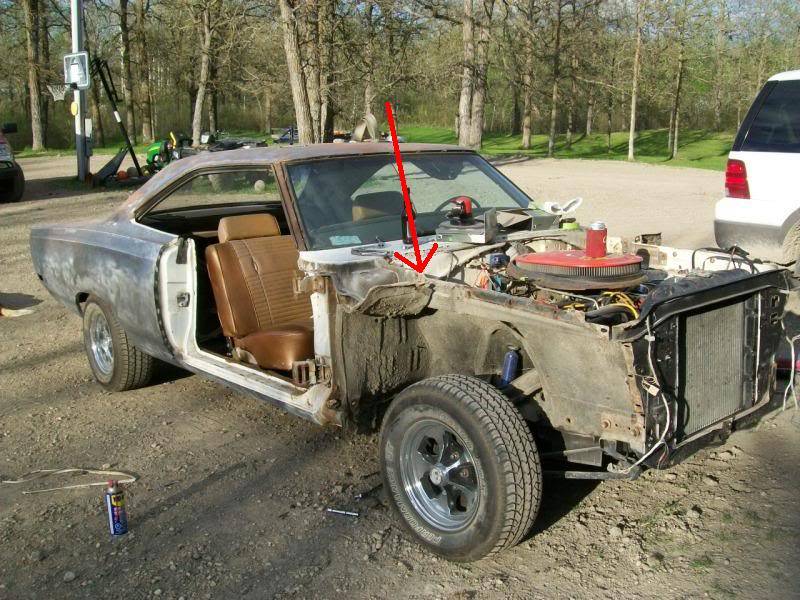

Sems our cars are very similar in the fender areas...
Dave, I am convinced your that pic of your tin chicken's beaten up fender put the hex on me!!! LOL, I was laughing my *** off when I got all that mud out all I could think about was the pic you posted of your fender!!!!
