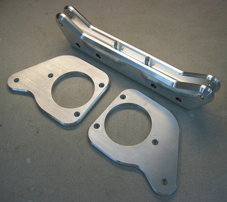

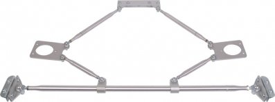

Does anyone make J bars, or something similar to a strut tower brace for 71 RR cars? Looking to stiffen up the chassis a little.

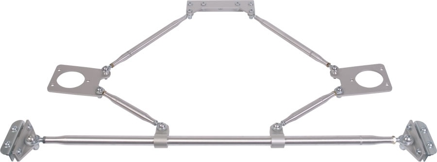

Haven't seen any specifically for vintage mopars but when I was building my wifes car I came across a lot of people who had built their own ....using hiem joints, adjuster and tapped tubing...I would think one could be easily mocked up using pvc.... you might check with TCP....

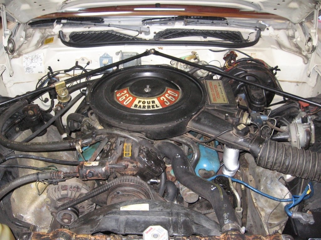

The later A&B cars came with them.This is a 79 "B" Cordoba.Maybe you can fit those items.Just a thought.
I was looking for something a little more sturdy than that. Looks like I'm gonna have to invest in a tube bender and build my own.
Keep in mind that the motor, along with all of the accessories (A/C, etc if any) that the tubes might have to be altered to fit around. Just saying. Other than that, the picture above looks promissing, tying both fender wells together

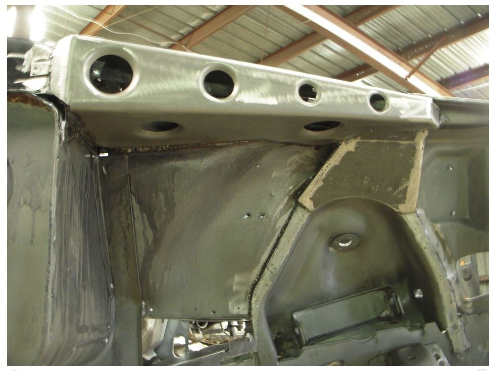

That looks real good. Do you have any pics of what the underside looks like?.. For my year(74) it doesn't seem that I would need to try an tie in my shock tower because of where it's at, relevant to what has to be done on a 71-72.

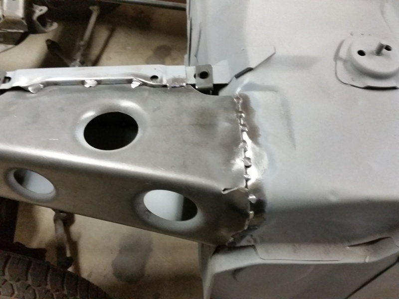

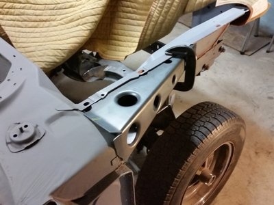

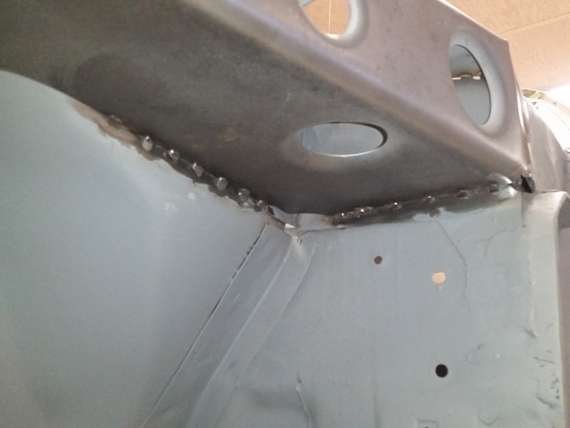

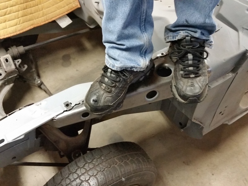

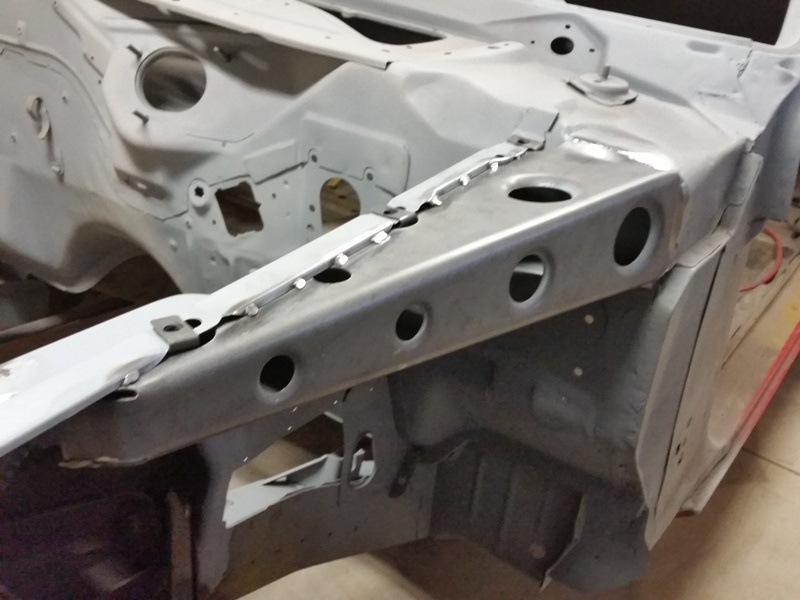

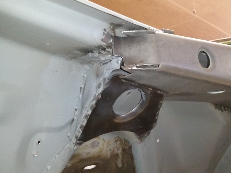

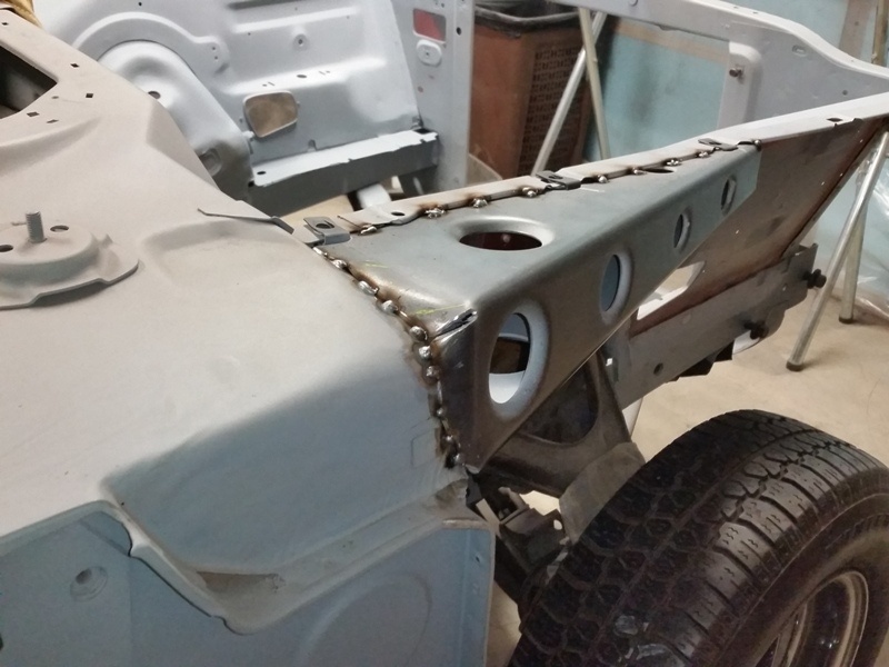

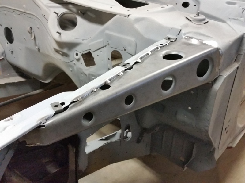

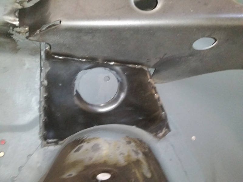

I just completed installing the inner fender braces from US car tool.
Like I mentioned, they are for an E-Body, but with a little tweaking they fit my 71 B-Body.

1973-4 B-body already have factory braces there and the upper A-arms are on the k-member not the shock tower like 71-2 . They are a lot stiffer from factory than any 71-2 B-body.

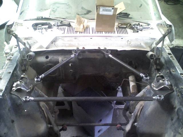

Here is the 71-2 B-body version..
https://xvengineering.com/products/xv-e-body-engine-bay-brace
Here is the 66-70 b-body says 68-70 but I think all is the same on 66-7. Has pics installed..
https://xvengineering.com/products/xv-b-body-engine-bay-brace
