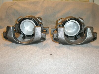

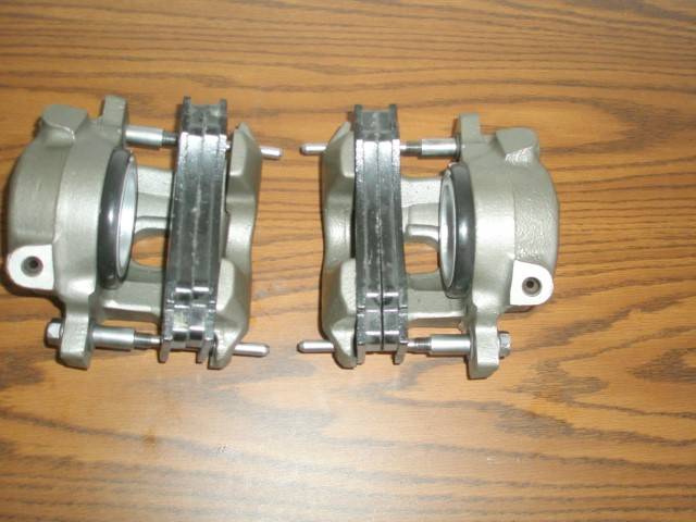

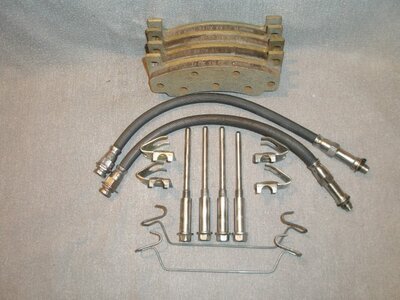

Kelsey Hayes, pin type, single piston calipers from 1970 B & E bodies, that i had, looked like this.
Brake hose screws directly into the caliper body.

All the parts catalogs show hoses that bolt directly into the caliper, and that's the type of hoses that i have in their boxes on the parts shelf.
That's why your having a difficult time locating hoses that you need on your calipers.

In 1970 the calipers used on the cars were considered to be the "WIDE MOUTH" design, a one year only style.
Are your calipers of this design?
But they still used a brake hose that screwed directly into the caliper body.
If not your car most likely has the calipers replaced with parts store units.
Show us a picture of your brake hoses, what your working with, that you want to replace.
A banjo bolt hose fitting won't seal properly on a caliper that's not made for it.
