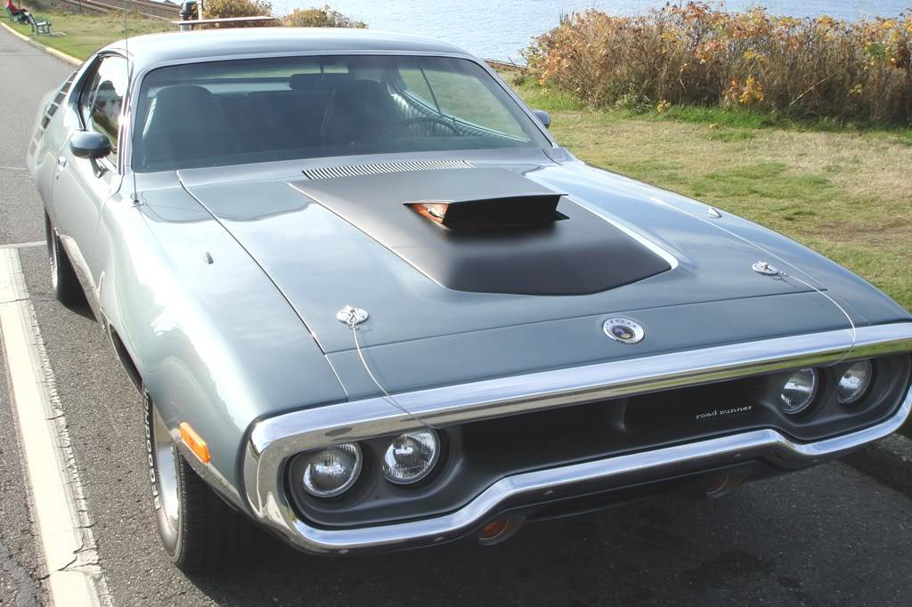

A few details that should be pointed out, the 72’ grille pictured in the OP appears to be painted Light Argent Silver or something similar. Not the color as originally designed, the correct color was darker and was meant to look like titanium. Under low light conditions, it appears almost “blacked out”. None of the 71’, or 72’ Satellite Sebring, grille variations came originally fully blacked out as pictured in the OP.

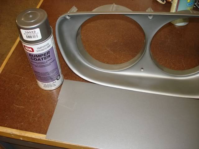

I was fortunate enough to have acquired an NOS center section and right headlight surround for my restoration with original paint intact. Locating a paint match for the NOS parts was daunting. Never able to locate any factory paint codes for the 72’ grille, I did find a very close match however with a SEM product.
