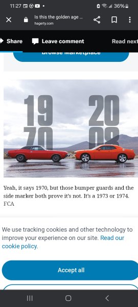

Precisely. Not the greatest of pictures,, but we can see that there was zero design effort put into the new challengers wheel arch.
A wheel half circle, would be a better description.

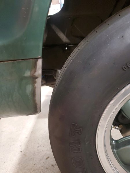

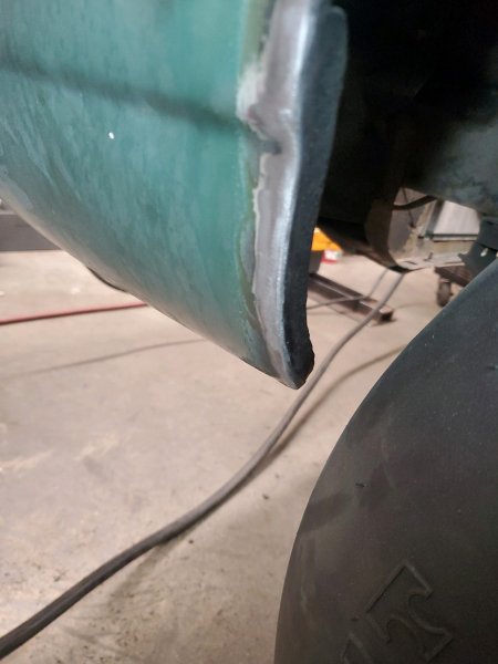

Shortening the distance would reduce positive caster. These cars don't have enough positive caster anyway. I trimmed the front lip on my sons 62 for tire clearance using 28" tall tires. It was easy.
Doig
Doig
I've thought about that. But somehow this car has made it 62 years without some bonehead screwing it up...just kind of hate to be that guy.
Ok, I’ve got a question, what is the purpose of adjustable strut rods?
Make sure your strut rod rubbers are in good cond. If in doubt, replace.
Doig
FYI, I was not saying that by trimming your fender lip, you did a bonehead thing. (when I was racing I would have done that also.) My car is not a rare vehicle, just a solid old survivor. Just don't want to hack it up anymore than needed.
