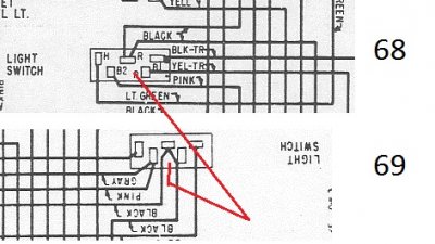

the diff between 68s and 69s to keep front parkings on when headlights is just one jumper wire on plug/harness between front and rear parking lights prongs. Those switch feeds separatelly both due the earliers setup... switch itself remained the same
You could get something wrong on the link between rear and front parking prongs/sources. Call it jumper, or splice or whatever
My 68's forward facing markers have always gone off with the headlights on. Always thought it was sapposed to be that way.
Now I'm confused. Are they on with the headlights or not?
it must be untill 68... on 69s that changed, keeping on the parking lights allong with headlights... the only change made was a jumper wire or splice to get together front parking lights with rears parking lights prongs on switch plug. Switch itself didn't change
since diagram between years shows the switch in diff position I reversed one of them to show them clearer.
red lines pointing out the unexistant jumper... those are the rear and front parking lights prongs:
another diff or wiring can be found is of course the sidemarkers light which is unexistant on 69s ( that's why you find two wires coming off the R prong on 68 diagram and not on 69 ). Also 69 harness shows a gray wire spliced into the pink one to feed the clock, thats all, but nothing major to the lights function.
Dunno where is really the jumper, or if there is an splice allong the harness getting this two sources together, 'cause diagrams deoesn't show necesarilly EXACTLY what the harness got, but must be around

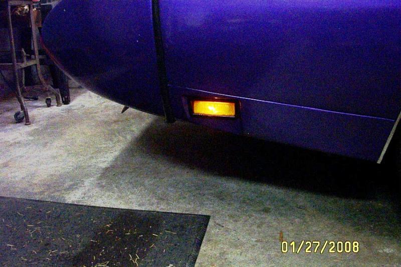

I also made my 69 reflectors light up in the Daytona

I was gonna make a thread on it, along with how to make them flash with turn signals, but I'll make a quick post here on how to light up the reflectors.
Find some mid-70's A body side marker lights, cut the square portion of the housing that the bulb sits in off of the housing, take the part you just cut off and sit it on the 69 housing on the inside, trace around the cut off bulb housing on the 69 inside, carefully cut the traced square out of the 69 housing, glue the cut off square on to 69 housing and install bulb holder with 194 style bulb and wire into parking light wire
Thanks A383Wing!
Pretty slick. As for the flashing with turn signals - believe you just reroute the side marker ground to the turn signal feed IIRC from other threads (and what I did on my F150)
yes, take the wires for marker light and connect them to both power wires on front turn signal/parking light....
