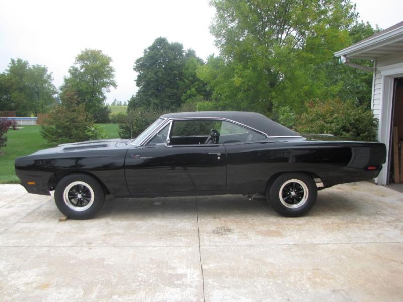

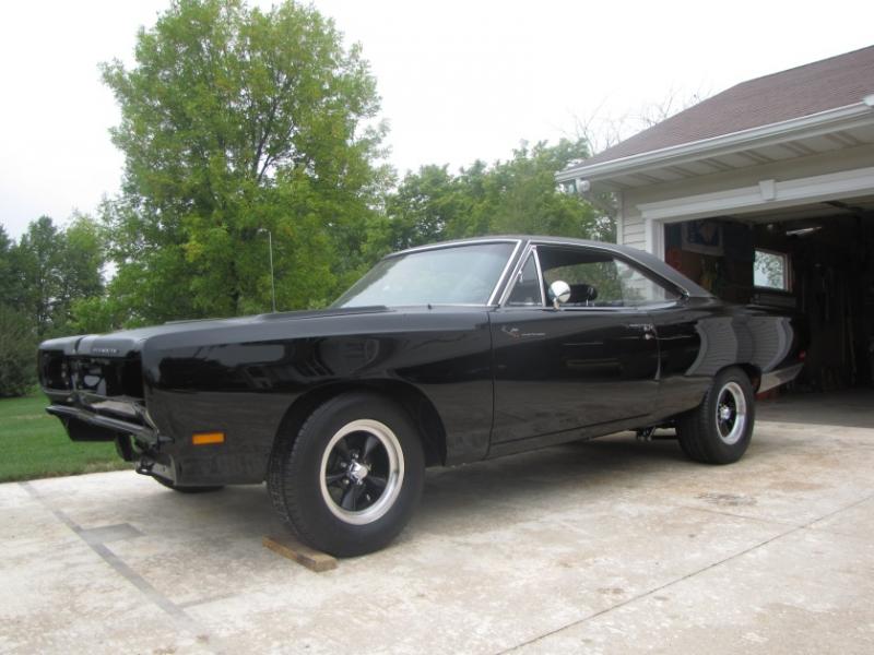

'69 Roadrunner......Have 15" X 7" up front with 3.75" backspacing. Rear is 15" x 8" with 4.5" backspacing, no issues with either.
good luck
Thanks man! Spent days trying to decide on rims. Real glad I went Black.
BTW tire size in the back is 275-60-15. Pretty sure that will tuck in your Charger's wheel well with the right back spacing Kenneth

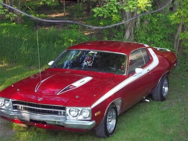

I have 15 by 7 on the front of my 73 and 15 by 8 on rear with no problems, Crager centerlines.. Ill have to check the back, i think they may be 9..
