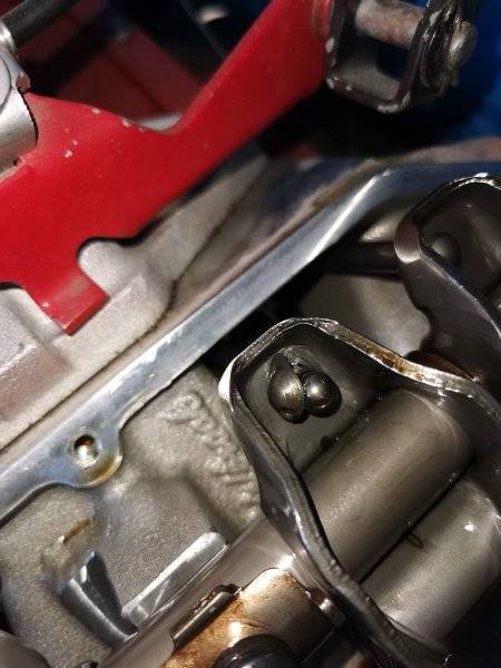

Well look at that. #7 cylinder intake valve pushrod right thru the rocker. I just hope there isn't lifter or cam damage.
Lack of oil? Happen to me on a 318 put rocker shaft in upside down. I don't know about BB's.
Still a mystery what sprayed oil all around the engine compartment?
Usually that happens if there is lash as the pushrod hammers the socket instead of riding in it, you should have heard ticking though, really odd if those are factory rockers..
