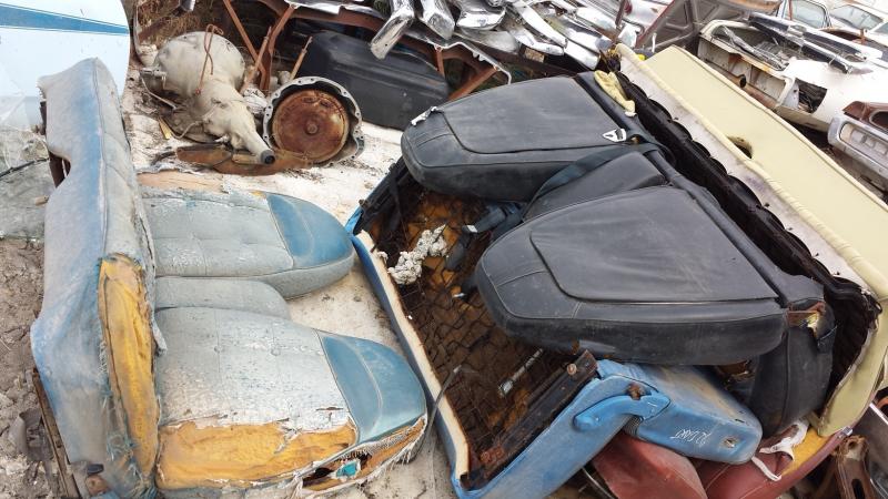

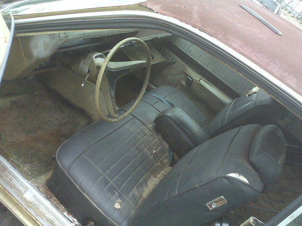

Here are the high back bench seats available for the 71-4 Charger and Coronet. I have 3 of them.

Those are the style that the older one from my youth had. These would fit the existing tracks already in the '72?
Thanks.
While I am in the thread, what does a good re-upholstery job run for front and back seats? Never been in that market before. Thanks.
Yes, they will fit your standard bench seat tracks. The blue one is from a 74 Charger, Black 72 and the brown one under is from a 73.

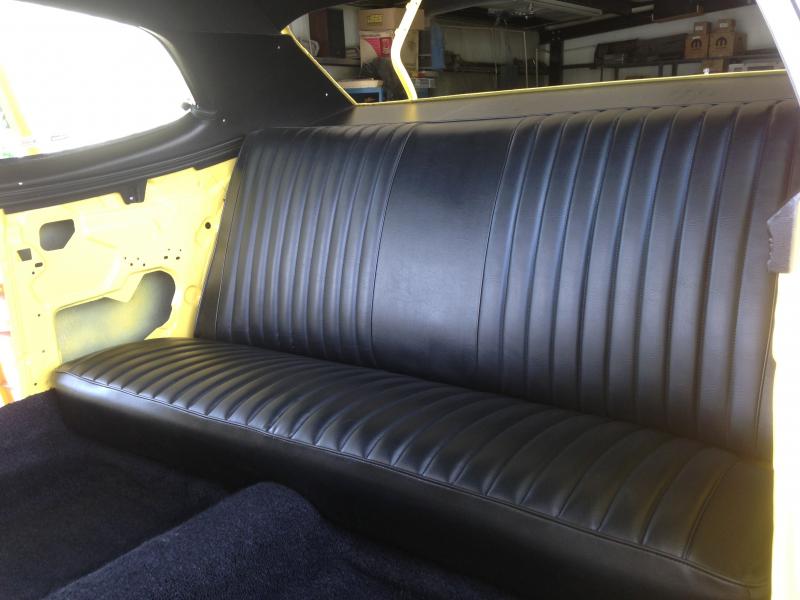

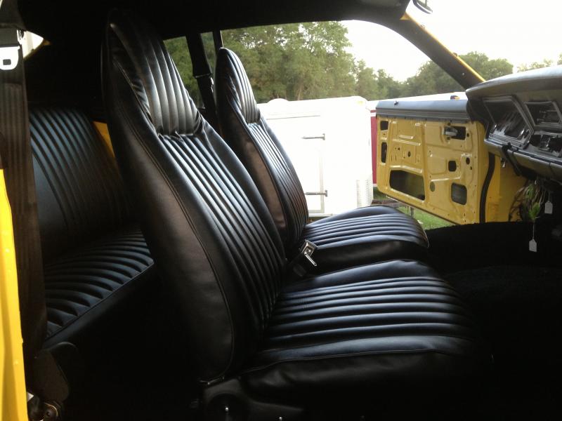

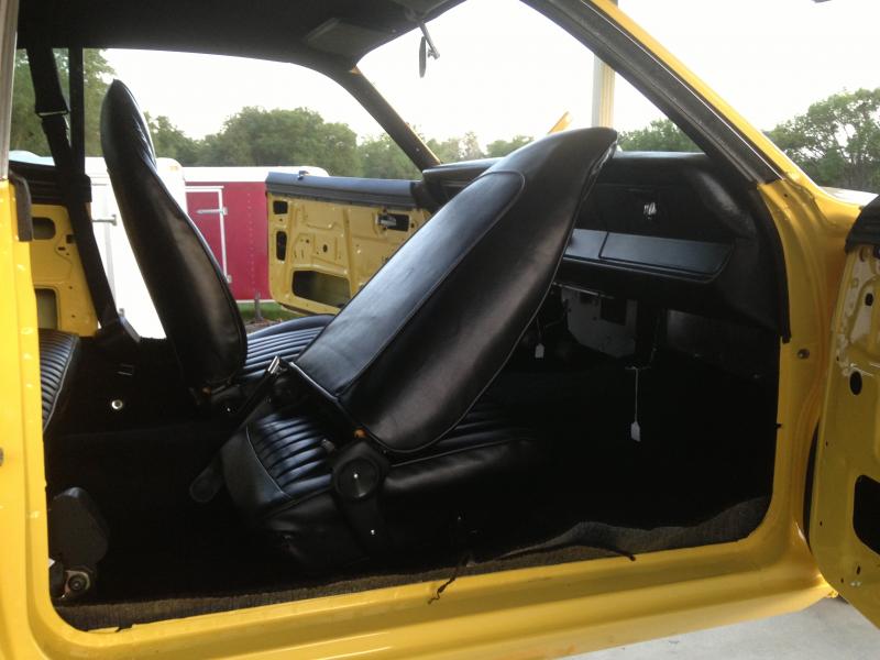

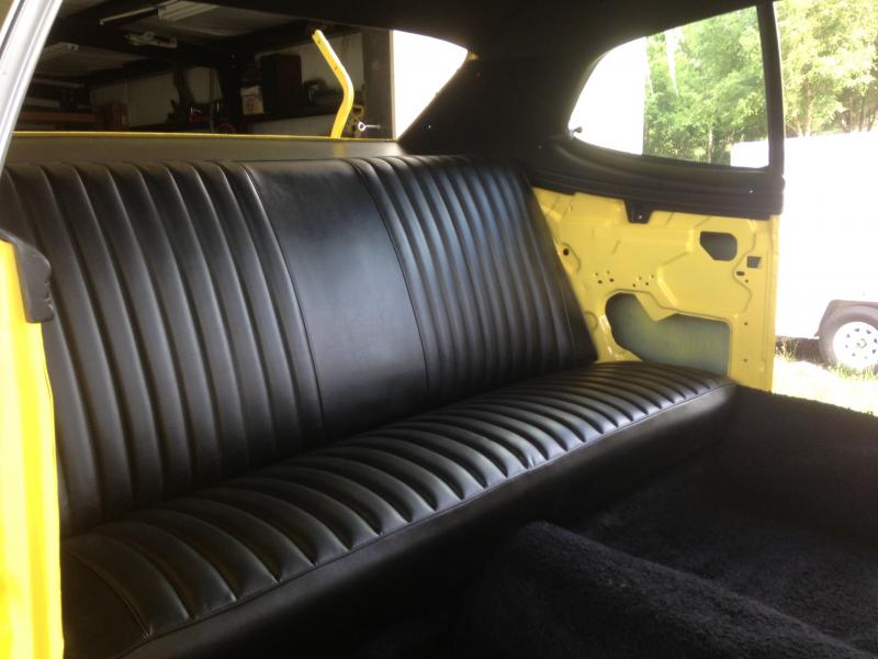

You can buy the upholstery from Legendary and install the covers yourself if your a little mechanically inclined. I did a lot of research and you can even find videos on YouTube showing you how.
Start with the back seat first because it is the easiest to do and you don't have to disassemble anything. While you have it down to a bare frame get the frames blasted down to bare metal and give them a good paint coating. This will also allow you to check out the seat foam and replace it as necessary.
I was totally overwhelmed at the thought of trying to do the work myself at first, but then after doing the research it didn't seem too hard to do so I gave it a go. I was very happy with the results.
You can also download and print installation instructions from Legendary's website.
Here is my handy work on the Duster I finished up two years ago.
