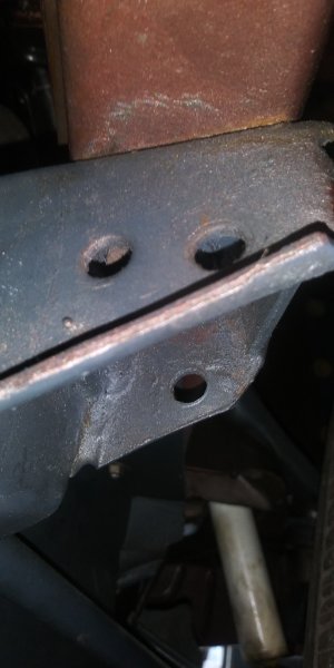

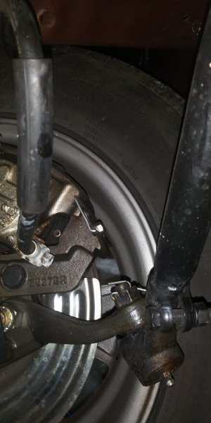

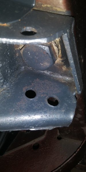

Front sway bar showed up in 1964 as part of the 426 Street Wedge package, along with 11" brakes. This bar mounted to the K-member with brackets. Post # 4 shows the holes for these brackets on the K-member. The open end of the bar clamped to the lower control arm strut rods. Kinda Mickey Mouse, but better than nothing. This bar was used through 1965 and early 1966, also. I have found these bars on early 1966 Chargers with 383. Late '66 changed to the style that was carried through 1970, requiring mounting tabs on lower control arms.

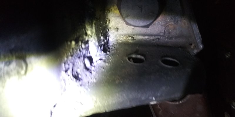

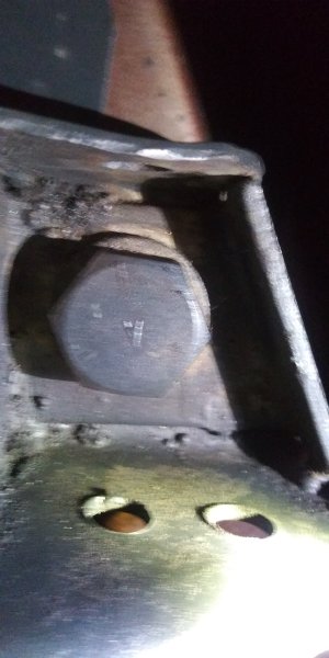

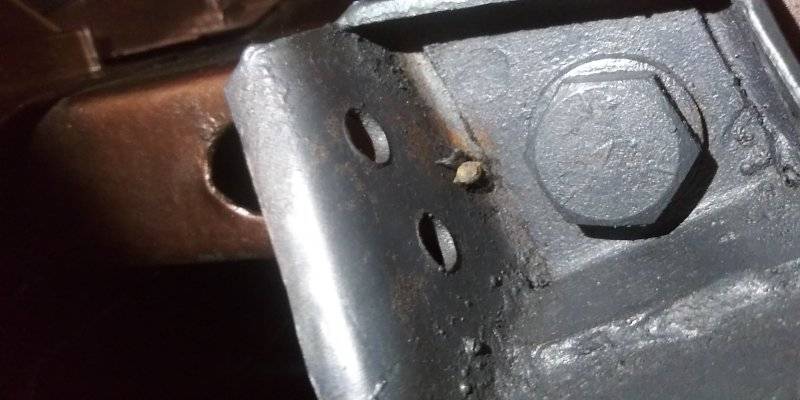

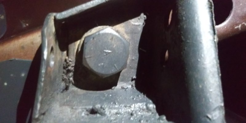

Did not get to see pics of the holes in k-frame.have pics of my k-frame having trouble sending them.

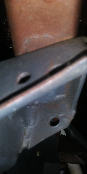

How much would it cost. I do have a ?how do you mount the bar to k-frame there are 3 holes drilled on each side but no idea if it mounts there.Thanks

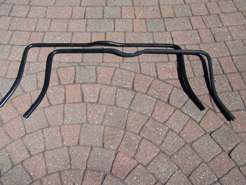

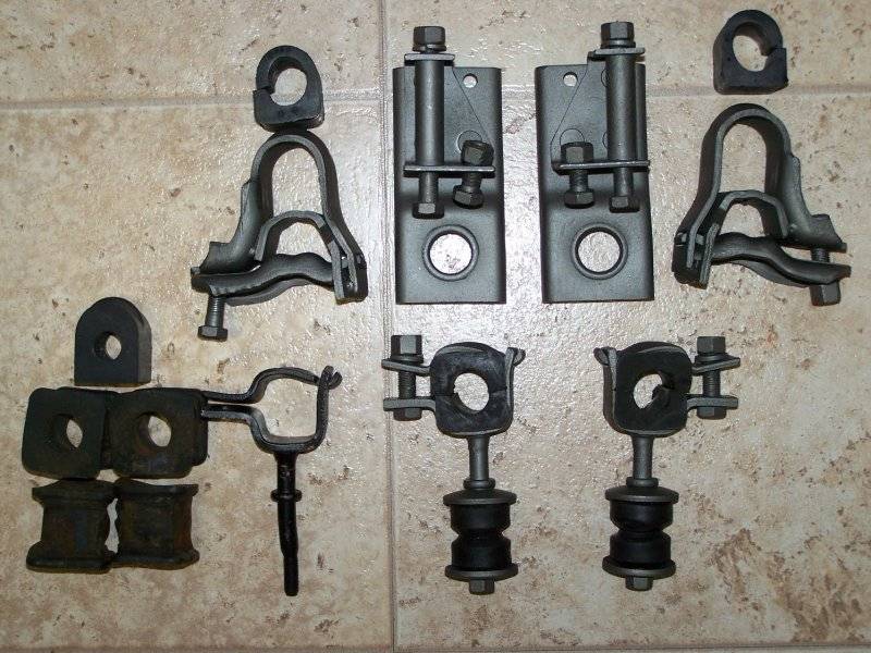

Here are a couple of pictures of what I have.
Two Sway Bars, One complete set of mounting hardware with newer bushings.
Misc. extra used and new bushings and bar link.
$225 buys it all. Can deliver to Carlisle.

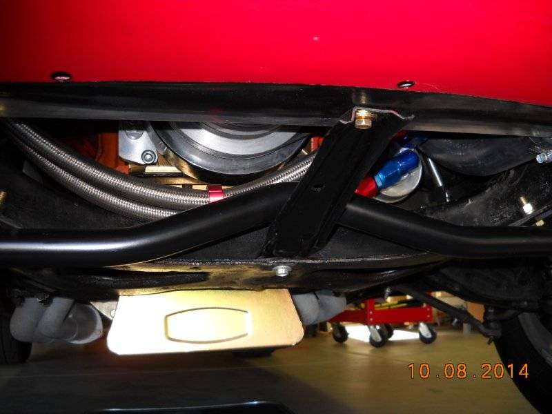

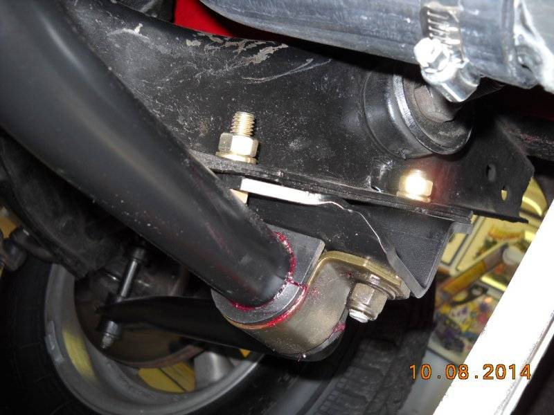

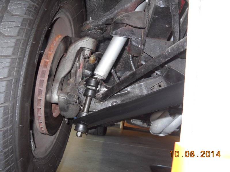

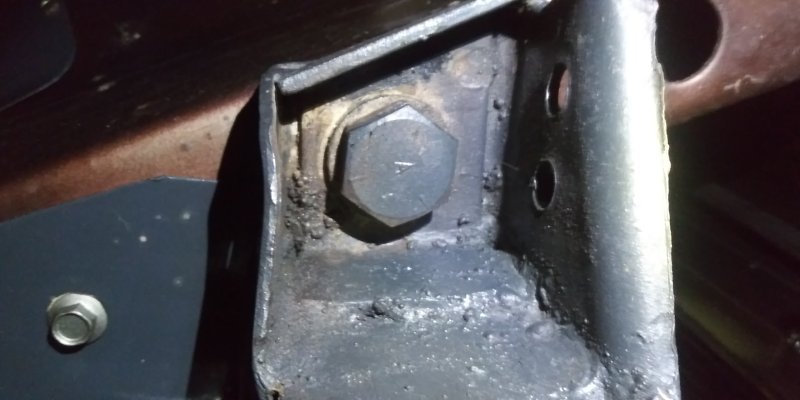

The factory holes in the K frame are where 2 long brackets mount.

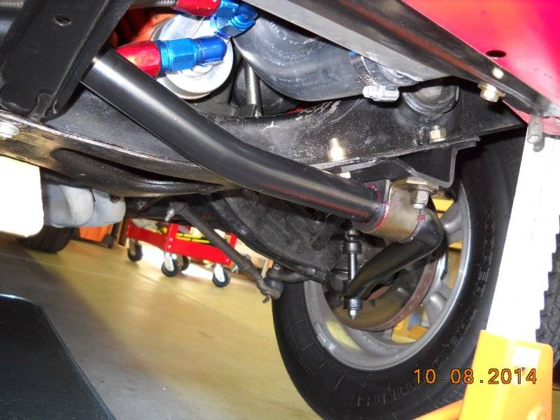

Here is some pictures I found showing the mounting.

Thank You I have to think about it I don't go to Carlisle anymore would have to have it shipped to my home i'm trying to send a pic of my k-frame as far as hole location having trouble doing that.Thanks for looking at my post.
All the V-8 K-frames have those 3 holes to mount the sway bar. My car originally had a 313, and has the holes. A sway bar bolted right in. In Canada, we could not get a 426 Street Wedge, but the K-frame still had the holes. Layson's have new rubber insulators for these bars.
