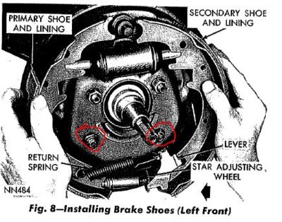

I'm trying to replace the front wheel cylinders on my '66 Belvedere, and I have a couple questions. I checked the FSM and it was no help.
First off, is there a way to get them off without removing the backing plate? I can't seem to get a wrench in there to loosen the bolts, which are partially concealed by the spindle.
And, if not, what is the bolt/nut sizes and torque specs for the backing plate, specifically the larger (bottom) bolts that have the cotter pin? Someone stole my large (over 3/4") socket set. It's not something I use often so I was just going to buy the size I need.
There are 2 I think 7/16 bolts on the back side of the wheel cylinder it self. No need to take the backing plate off.
The steering knuckle crowds the bolt head.
I took a 1/2" 12 point box wrench and ground it down on the flat parts just enough to squeeze it in.
Once you break the bolt free, use the opened end to get the bolt out the rest of the way.
Clean the bolts up, soak them in penetrating oil, make sure the wrench is well engaged, and give it a snap.
If you strip the head, it's on to plan B.
It's tedious and takes patience, but it works.

That is really a last resort, MO. I'd grind down a wrench offsite more than needed. Once you have it on tap it with a hammer to loosen bolt.
If loosening backing plate just to gain clearance ( not removing nuts) would work. Remember you have the torsion bar tension on the lower ball joint bolts. Don't get hurt!

Wait- is the knuckle 2 seperate pieces? If I remove the bolts from the backing plate, is the whole assembly going to come apart?

The 2 lower bolts hold the lower ball joint to the backing plate. The lower ball joint has torsion bar tension on it and is separate from the knuckle.
To take the backing plate off, you must release torsion bar tension.

Well I'm really glad I asked here... otherwise I see I could've ended up in quite a pickle. I assumed the spindle/steering arm was all one piece.
Luckily, Home Depot has a 12pt 1/2" combination wrench for $3...
Thank you guys
