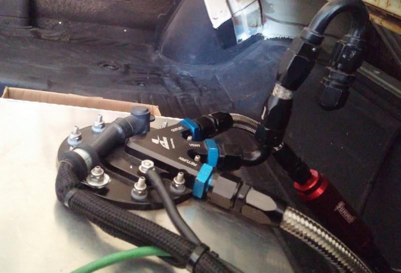

I have a trunk installed aluminum fuel cell with a top mounted-in-tank Areomotive fuel pump.
The fuel pump assembly has a AN-8 vent fitting, right now I have a makeshift gooseneck vent installed.
I am thinking there might be a better vent setup? Maybe a check valve that can let suction vent air in but not let overflow out?
Whats a good setup? I see there are allot of checkvalves to choose from.
Thanks

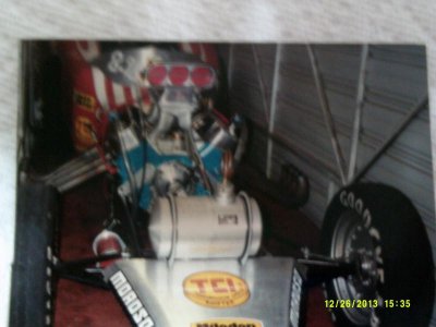

not sure you can see it in the photos below or not, old style vent tube
