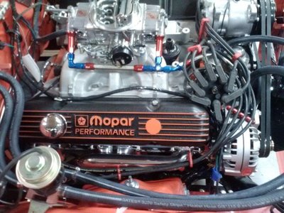

Is it better to have the filter before or after the pump? I dropped the motor in and it came from my builder with a stainless line going from the pump to carb. For now, I put the filter before the pump. Not sure if I should or have room for a filter after the pump and how to incorporate the filter with the line installed. FYI, 400 engine. This is the best picture I have for now until I get home

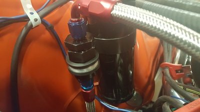

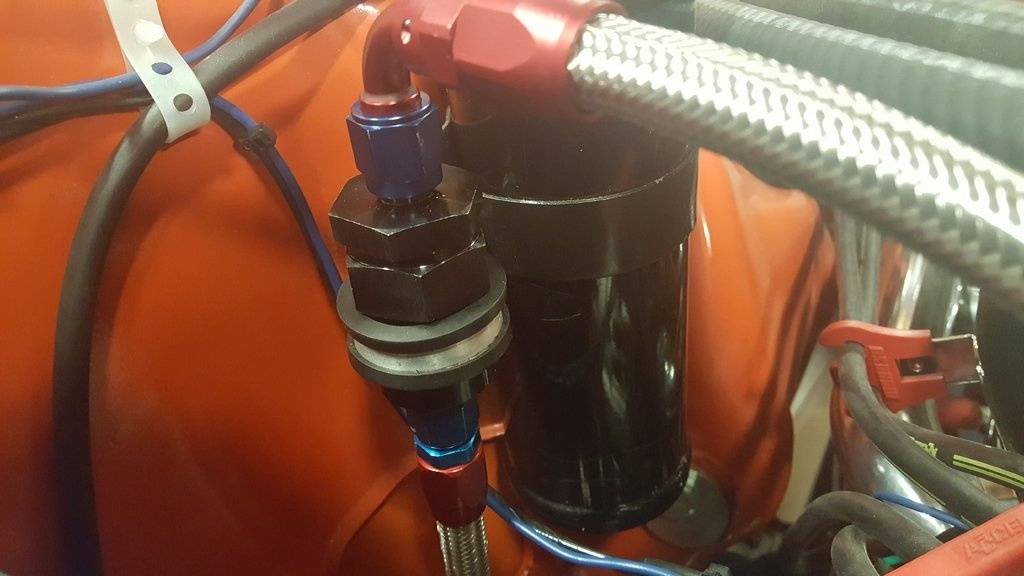

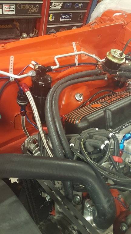

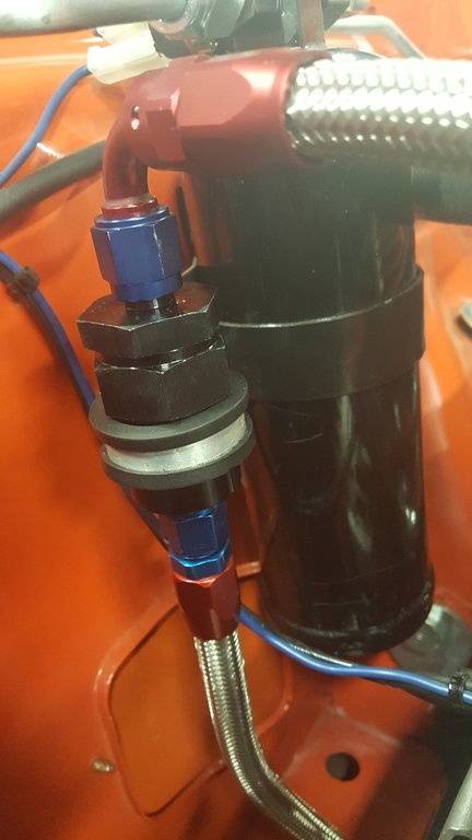

Finally got the fuel filter figured out and installed. Happy with how it looks and turned out. Mounted the filter next to the receiver/dryer, using the same bolt for the drier, then routed it with the same stainless steel hose. This way, I can access it and clean if need be. I didn't want to install it next to the pump or under the alternator because of accessing it. lines are out of the way of the engine and tucked away.
