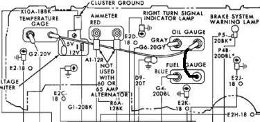

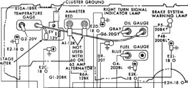

Check your “ACC” fuse for switched power, the limiter is fed from that fuse.
However, the temp and oil pressure gauge are also powered from the limiter, you didn’t mention they were not working as well.

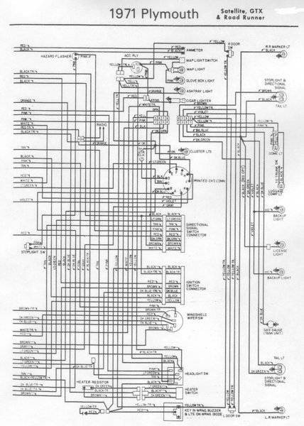

Be careful with that diagram you posted from the FSM, there is an error, does not show the feed to the fuel gauge from the limiter, should have a jumper from the gauge above it.
These schematics may be a little easier to trace down your wiring on. Be sure to check all fuses. I had no dash lights no turn signals and a few other issues.. Turned out to be a blown fuse that looked like it was in good shape.
