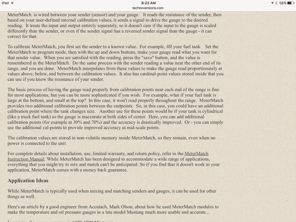

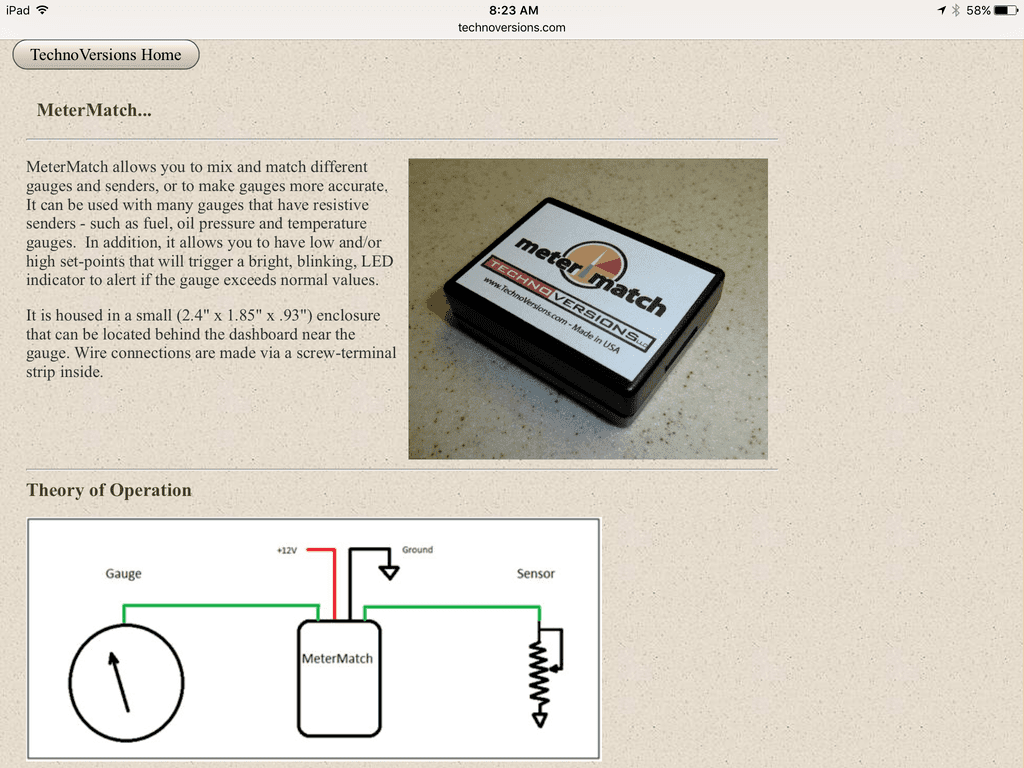

http://www.technoversions.com/MeterMatchHome.html
Buy one of these and you will be the guy to easily adjust the accuracy once and for all with practically any sender unit.
Neat. Going to take a hard look at this.
