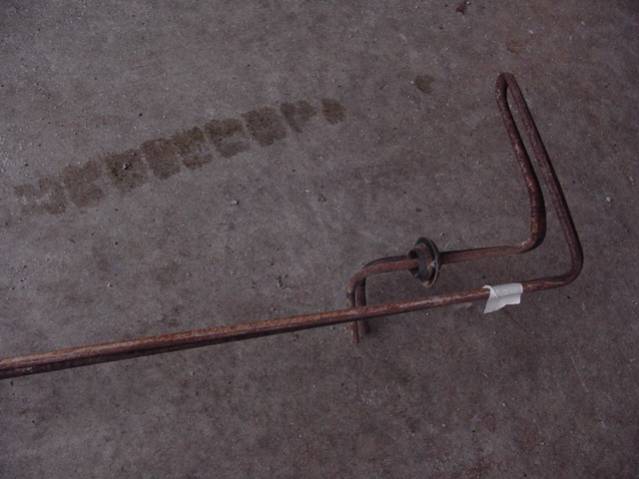

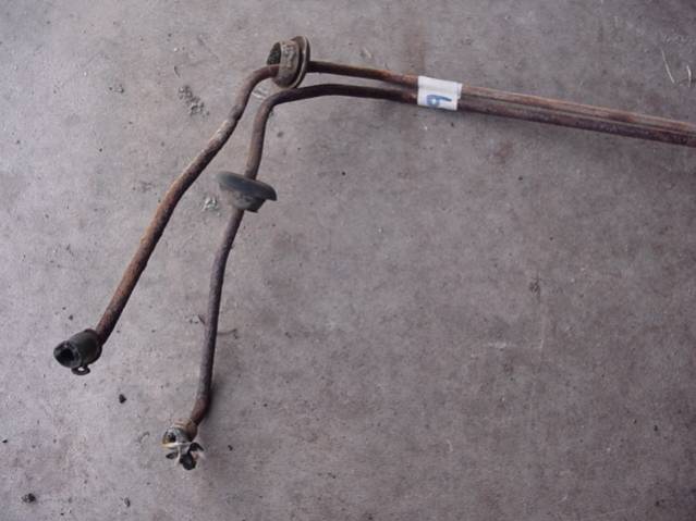

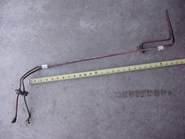

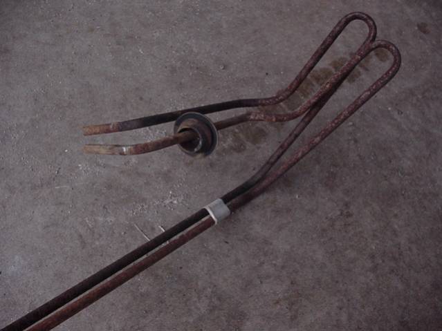

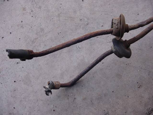

I`ve done work on a 69 RR and a Sat. before where the sending unit had the vent line attach to a factory bent, 1/4 steel line by a small 5 inch piece of rubber fuel line. This steel line goes directly up through a rubber gromet into the trunk compartment into the high area over the diff. and outwards toward the passenger side and then goes down again through another rubber gromet into the frame rail. This whole setup would be roughly 10 inches higher then any part of the tank and would be considered venting. I have two of these lines ,if you`d like a pic ,just let me know and i`ll dig one up. :yes:

I don't have one to check with now, but my memory says there was a vent tube from the gas tank that ran to a 5/16th line that looped upward thru a grommet into the trunk, about 8 inches, did a U turn, came back down thru the grommet and exited beneath the car. Anyone able to check that out?
Here`s your pics :yes: of both those lines. One from a 69 RR and the other from a 69 Sat. no difference. 1/4 outside diameter & both grommet #`s 2216552. Hope these help.
