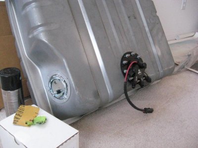

I agree with furryfrog. I installed the Aeromotive Phantom into a BRAND NEW tank for my '72 Charger in late 2013, just after the Phantom setup was released. It works great.
A dedicated aluminum tank would have made for a bit cleaner solution, but as stated before, they don't mass-produce them for our cars yet. They will custom build one for you, but it's expensive and takes a bit of time. I might go this route next time.
Aeromotive Fuel Pump Module installed in the fuel tank
