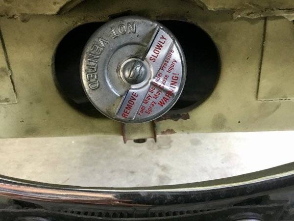

Hi Dennis
Replying to this old thread, hoping you can help
I have a 70 RR, with the after market tank,
With the correct vent lines
which I am pretty sure the internal vents line were mistakenly reversed
so I have tried switching the lines
my problem is that fuel comes out of both vent lines
the long external one empties into the right rear frame rail, and eventually out the holes in the frame rail near the exhaust resonator, seems kind of dangerous.
does your car do this? the car came to me with a vented gas cap which I think is incorrect, not sure if this would make a difference???
any suggestions would be much appreciated
