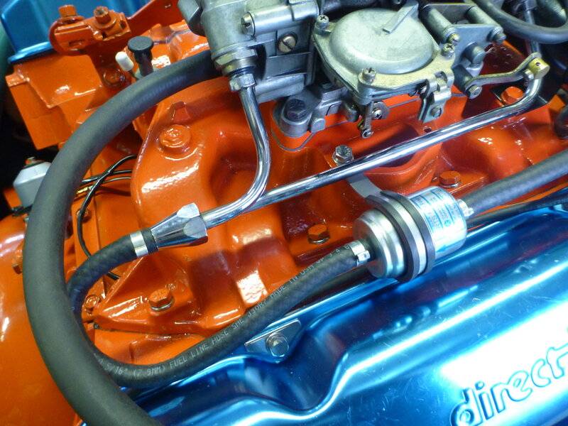

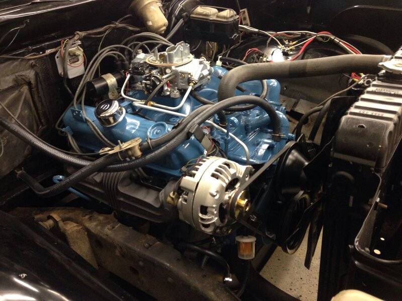

I've never had a 3310 so I'm not sure what they have for fuel inlets, most of those dual inlet kits say 4150 or 4160. I've used the first and second one you posted, the second one I remember having an issue with, maybe the plating going to crap? If the one 91r/t shared is how yours is then yeah, make your own.. looks like standard flared lines? All of my carbs took the gasketed fuel inlets which made those kits more appealing.
