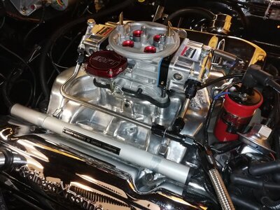

Holleyis this holley brand or Mr Gasket?

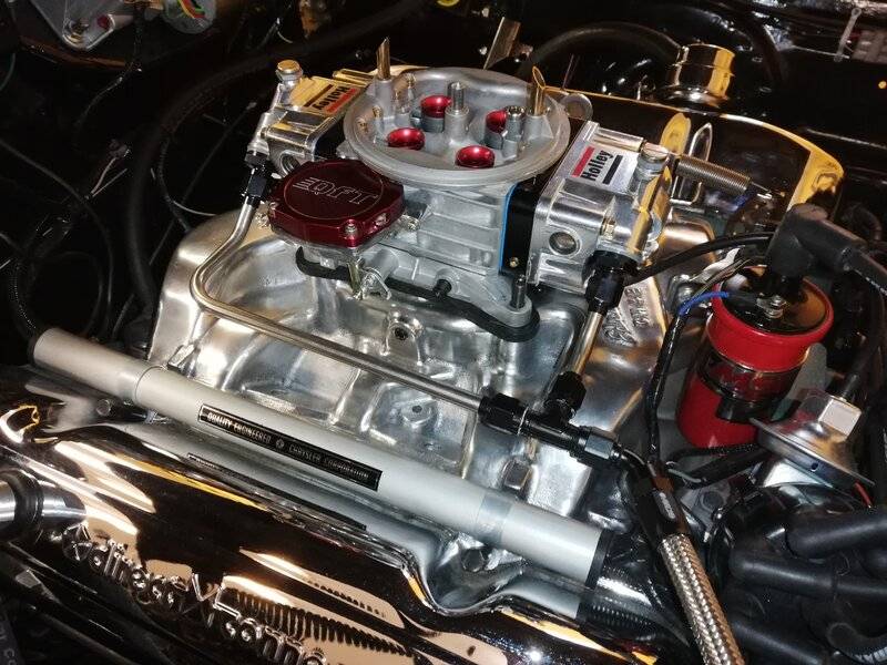

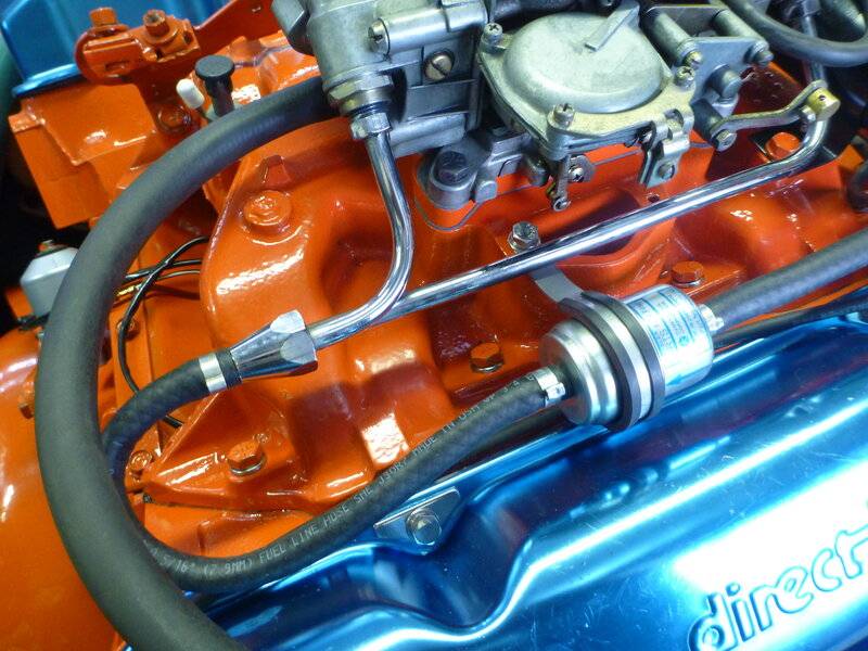

Done a number of 3310's from back in the stone age... never a leak.Never in 40 years have I had a Holley feed line that leaked... this is a 3310..

is this a kit you purchased or did you build this ?Ive been using one with AN-fittings (4150), took it apart almost every day during the summer when tuning carbs, never leaked.
