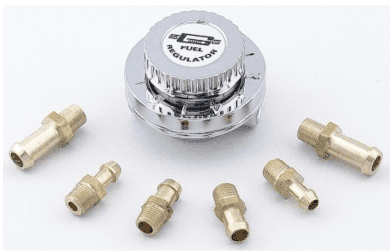

Might be a. good time to change the oil. These work, 1-6 pounds. I would rather source a proper pressure pump than add parts and fittings to a fuel system. Less chance of a leak someday.
