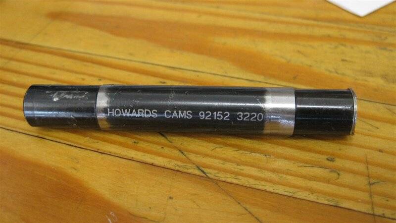

Are you using a flat tappet or roller cam?
WTB and get one from someone that has an OE kicking around. My 156,000 mile OE is still full spec length!!
Make sure it measures 3.220 or real close.
Definitely do not buy a Howards Cams. This one only has 1k miles on it.
Seems as though you could case harden one yourself.
I have a friend that does steel treating, I'll bet he could take almost any of these purchased parts and make one pretty indestructable.
Yeah, don't get the Comp one or the Howard's one either. My 440 ate both like candy.
Mopar part number: 2463921
A couple places still have them.
