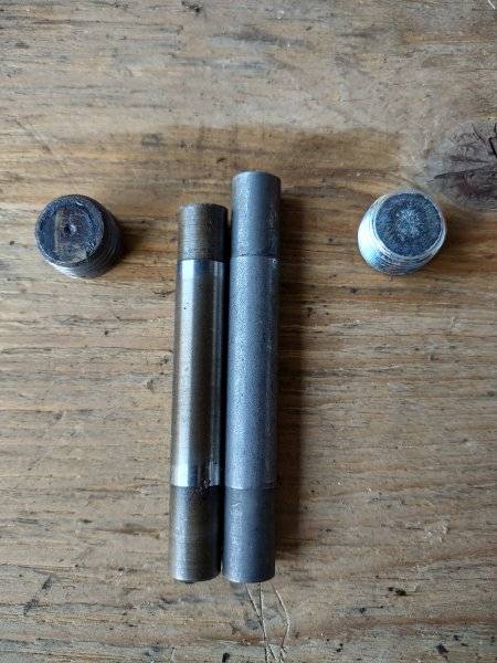

I found the issue that caused me to lose fuel pressure on the way to Carlisle. The fuel pump pushrod, which was the original one from the 361, had worn down about 1/4 inch. The fuel pump on the car was a stock style Carter, not a HP one. I bought a new fuel pump pushrod from Mancini's at Carlisle, and was assured that the pushrods they sell now do not have wear issues anymore. I also bought a new stock type Carter pump. I used my bore scope to try and check the cam lobe, but other than seeing a wear pattern, I couldn't tell if it was excessively worn.
My question is, what if anything can I do to avoid the same problem? Also are the pushrods the same on both ends? I noticed the new Mancini pushrod has two tiny dots on one end.

They are the same on both ends so it can go in either way. I am amazed to see an original worn that much. Wondering if the metal on modern cams are causing this or just ground wrong??? What cam? I had one go south on a Comp 268.
The cam is an old stock Wolverine Blue Racer, same as a Melling or an Edelbrock Performer.
I sure hope Mancini is correct about having the hardness problem resolved. Seems like every couple of years someone else is claiming the same thing, but that hasn't been the case yet.
I would think that is excessive wear with 125,000 miles on factory fuel pump rod
Did you check the cam? Was only the pushrod worn?
I did not, replaced the push rod with a NOS one and sold the car a few months late. Was my first experience with a push rod failure. If it happened to me I would definitely take a good look at it.
