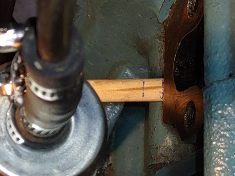

I have tried a borescope, but the picture is not clear enough.

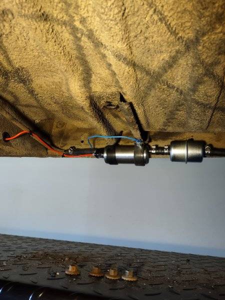

My buddy says the same thing, just permanently wire the electric pump and forget the mechanical pump. This is the pump assembly I have.I have been using electric fuel pumps since the early 80s on most of my engines. The one on my 78 Chevy P/U came in extra handy when I got a load of watered gas at a local gas station. I was able in a couple of minutes to empty the tank of fowl crap and get reimbursed from the station for more than my costs. After confronting them, they admitted knowing the water was there but, still sold the fuel!
But, I digress, always had good luck with electric fuel pumps. I like the newer rotary pumps for their lack of noise.

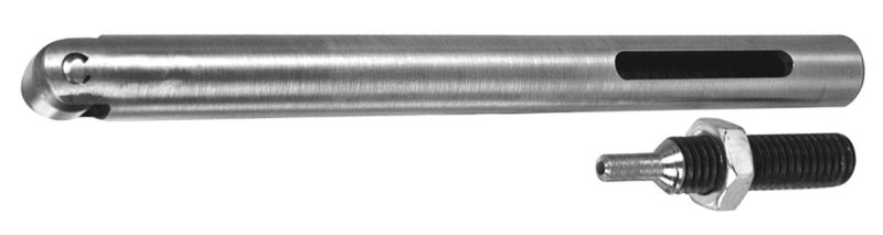

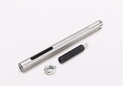

They have them for Chevys.Imagine if someone made a pushrod with a roller wheel on the end that makes contact with the cam lobe!
Is that out of an LS motor ? Starting to see the attraction now.
That is amazing. I was just guessing that one existed somewhere, I didn't know that it actually did.
