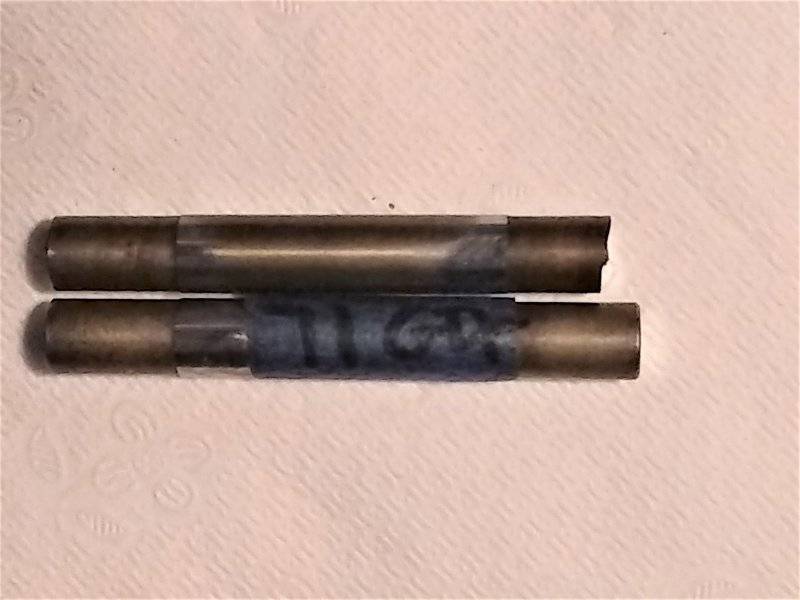

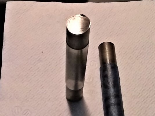

Here is a pic of a push rod i removed from my '66 Imperial (440) about three weeks ago. I had long crank times after sitting a few days,So i replaced Fuel pump and filter and noticed a well worn rod.Luckily i had a another used rod to install.Engine was Professionlly rebuilt about 15 years ago.Maybe 10 k miles on it.
IMG_20220614_191932194_BURST000_COVER_TOP.jpgIMG_20220614_191952028_BURST000_COVER_TOP.jpgIMG_20220614_192017878.jpg
After wiping out an original in 1500 miles went with a Comp lite weight with Cromoly tip. So far so good. Used with a Carter hipo pump and Comp cam.
