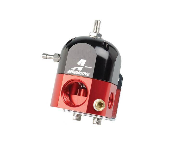

Installed both the fuel pressure gauge and the boost gauge. The fuel pressure regulator is a newer looking Aeromotive. No id on it but looks exactly like this one.
Pressure Range (psi): 3-15 psi
https://www.summitracing.com/parts/aei-13204
Took the car around the block. Normal neighborhood driving the boost gauge barely comes off 0, fuel pressure is at 6 psi. When getting just a little more aggressive with the throttle, as boost comes up fuel pressure comes up with it. I saw 8 to 10 psi of boost for short bursts. Car ran fine. I layed in to it one time to build boost and watch the gauges. As boost climbed over 15psi, fuel pressure went up with it then the engine fell flat like I hit an off switch, got off the gas immediately. I heard the PSSSSHT of blow off valve open. Fuel pressure dropped down to 6 psi and engine was idling. Hard to watch the gauges closely while driving.
That fuel pressure regulator is rated 3 to 15 psi. Can I assume 15psi is max output of the regulator even with boost?
We already know the fuel pump can only put out 22 psi.

So what to do if you dont know the engine build? All you have is whats in front of you between the frame rails?
I see it says 1:1 boost/vacuum ratio. I would personally assume it maxes at 15 psi as carburetors don't run over 7-8psi. But I'd call Aeromotive to confirm. If you set idle at 6psi and are going to run "X" boost, it needs to be able to regulate 6 + X psi. Fuel pump needs to be capable of 6 +X psi also. You will need to know what your turbo wastegate is set at to know it's max boost psi.
I found a spec sheet for the F1 Pro Charger. It is capable of Max boost of 38 psi. I would assume that is dependent on pulley sizing. That being the case, the fuel system needs to make at least 45 psi max fuel pressure to keep pushing fuel against the boost pressure. Right or wrong?
