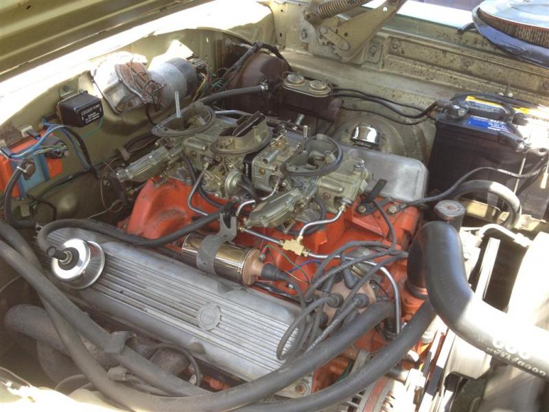

I bend up my own lines for just about everything but I don't have a pic handy. It does get a bit tight around the distributor and fabing one up can get tricky but is very doable. I ran the line up behind the alternator and between the distributor and valve cover. The six pack runs the line around the vac advance side of the distributor.
I should say I don't have a pic of the single 4 BBL set up. Shown is the six pack fuel line kit and it fits well. You can also copy this most of the way up.
