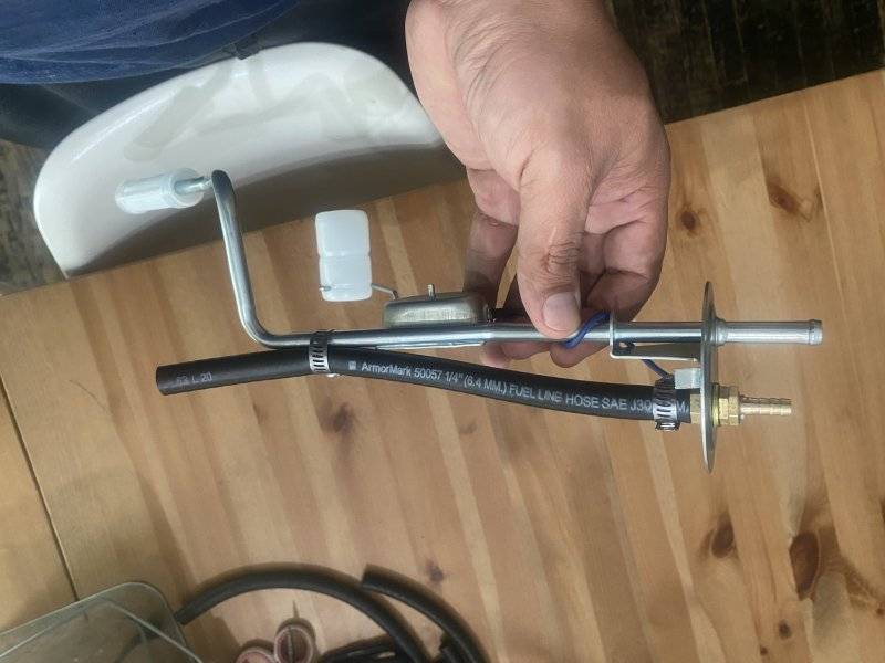

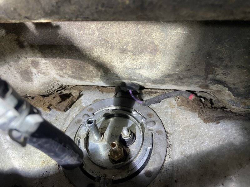

I agree, look at Inline Tube, they have most lines needed in steel and stainless. It's also pre-bent to factory routing and fits perfect. I too live in Texas and would recommend adding a fuel return line to avoid vapor lock during these intense summers. I modified my sender and added a rubber line. Do you need a fuel pressure regulator for your carb.

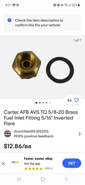

Thank you all for your responses so far! I should have been more specific. I am specifically looking for help understand what fitting(s) to use to connect the 5/16 steel line to the 5/8-20 Edelbrock carb intake.
