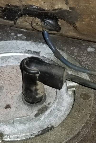

Good evening members. Has anyone found a replacement connector or pigtail with the fuel sending unit connector? I have looked at previous threads and got no reply on that elbow connector. I have narrowed the fuel gauge inaccurate reading to the connector at the tank itself. Have tried cleaning and crimping the elbow connector and sending unit stud with minimal gain in continuity. I lose 10 ohms from the inside of connector to the wire attached to said connector. Gauge works properly, sending unit and tank are grounded. Looked at Rock Auto and Napa etc.with no success. I just want the connector.
