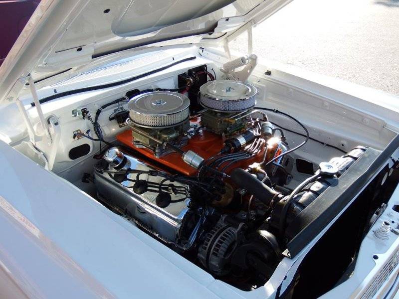

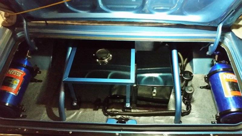

Might be overkill. I run an Aeromotive A3000. Good to 3000 h.p. it has filter and by pass built in. I drive all over on the street. The one pump is enough for just motor and the addition of both kits when sprayed. No dead head, -12 feed from cell to pump, to fuel log, -8 to carbs, -6 fuel & nitrous solenoids and a-8 return of off pump regulator.

6PKRTSE: You have a fantastic engine compartment, well thought out. But like you said, little too much for my needs. :)
