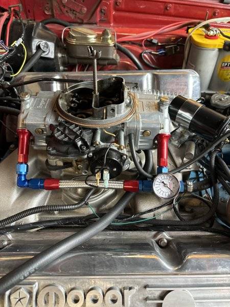

When I go start it up, fuel was pouring out of the fuel bowl vent (?)in the front, see photo. Car started and ran rough and turned it off when I noticed fuel coming out. I can hear fuel run down the intake too.
Any idea what I screwed up and how to fix it?

What is your fuel pressure? Either its to high or you got debris stuck on the needle and seat.
Look closely at the O-rings on the needle and seat. If they look good and are still soft just put a little lube on them and reset the floats. Make sure you check both bowls.
Gus
Thanks, was thinking I probably need to re adjust the float level. Would removing the carb inlet filters have any effect on this?
Yes the fuel line might have had some debris in it and it just went into the needle and got stuck. I would probably have a few new needle and seat assemblies ready to go so you can get it back together right away.
Gus
To add to what's been said, I'd drop the fuel pressure down to 6 lbs.
Sounds like added pressure not letting N/S set also and debris. Careful setting float height when running for fuel dribbling and fire issue. Holley used to have screw in sight windows for sale but I see these days they’re already installed. Just be cautious

Those filters you removed may have restricted pressure a bit. Without them, pressure at the floats increased, and overpowered them, causing flooding.

Update-adjust the front floats and got the car to idle. Then when it warmed up idle speed jumped up to 1100rpm, backed down the idle screw with no effect. Gasket on the needle seat assembly is old and hard, so thinking that might be letting fuel by thus increasing RPM. I’ll replace the gaskets and see what happens.
Fuel does not increase the rpm, air does.
