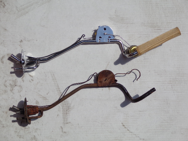

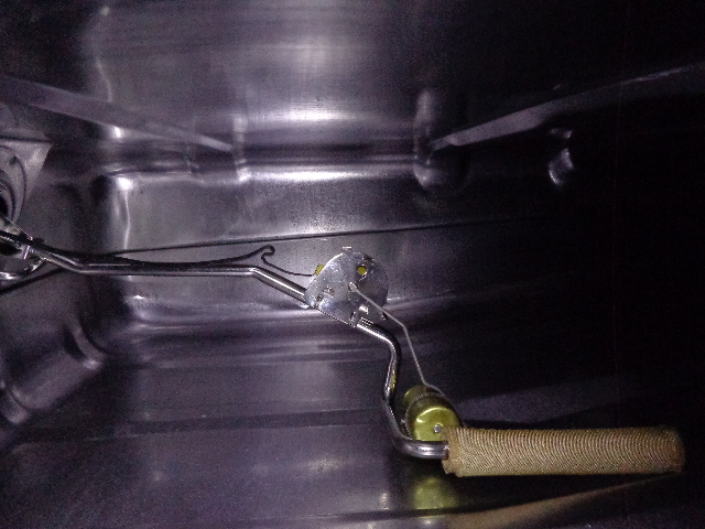

Here's what my old and new sending unit look like, and of the inside of the tank. just for reference. DSC07340-2.jpgDSC07343-2.jpg
Well got her working...sort of..when tested out of the tank the ohm range was good empty and full. Now in the tank I had about $25.00 in fuel and it read 1/8th tank I put another $43 in and she went to full. ..Ok all is good..but after driving about a half hour it was down to half tank..still not right.
Keep playing the game I guess.
